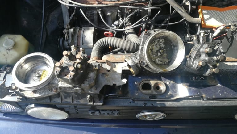

I have removed the metering unit from the car and found the following:
1. There was pressurised fuel at the union for the cold start injector
2. There was NO pressure at the 4 injector lines
3. The disc/flap meets no resistance from the metering pin when I move it
(Video here)
MK1 golf fuel distributer strip down pt1 - YouTube
Next, I'd like to try and get to the metering pin - how does the unit come apart? I can see two torx head screws, but they don't seem to go through to the metal panel.

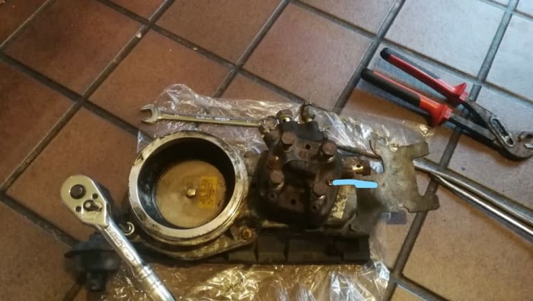

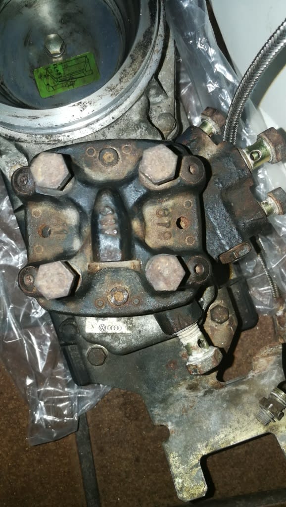

The thing I am uncertain of is how do I remove the distribution unit (where the injector lines etc fit) from the metal frame it's sitting in?
I know to keep the injection unit in one piece, but how does it unscrew from the base plate so I can get to the needle ?
Regional Host NE
Regional Host NE
I can only see two torx bolts though? The one you marked and one opposite? As per pic below.
Appreciate your help on this!
Regional Host NE
Regional Host NE
nicci21paul said
needs to come out mate
What does?

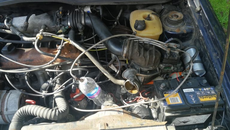

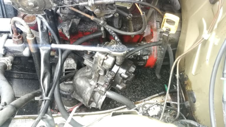

The car it came off ran, so it was a known good unit.
All the outlets are the same as the one on the golf, so I was hoping it would show whether the metering unit was at fault.
I got the bolts all swapped over and fitted the unit to the car - it's just plumbed in and not routed correctly (incase I need to swap the original back in), with injector 4 going to a bottle so I can see if it gets enough pressure to open.
We got…
Nothing.
There was no fuel in the test bottle, and I could only hear the pumps running intermittently.
Time to turn my attention to the fuel pump relay. Logic being that the metering head needs to be able to provide 75psi to the injectors to get them to open.
The lack of any fuel in the test bottle suggests we are not getting sufficient fuel pressure at the metering head.
This could be either due to the fuel relay being intermittent, or the main pump not providing pressure.

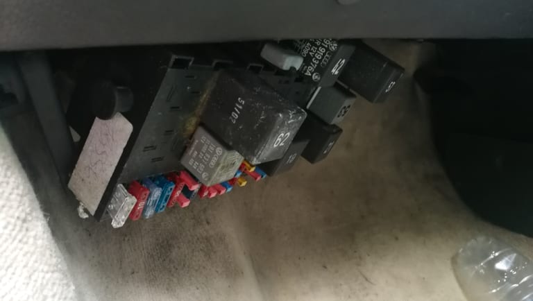

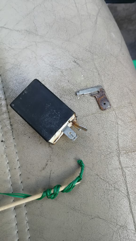

Tucked up in the passenger footwell, the relay is easy* to reach.
Initial inspection showed signs of rusting - never good
After some gentle persuasion with a screwdriver, the relay was out
Time to order a new one then.
As a final hurrah, it also decided that it'd like to make some horrible noises when the starter tried to engage..
