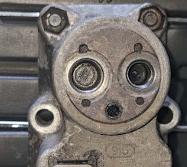

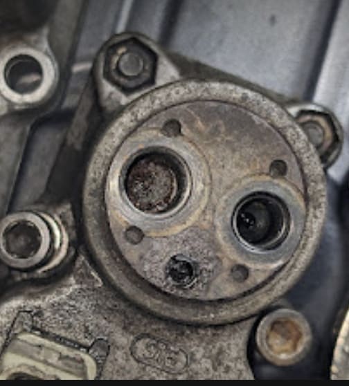

if it runs fine after engine is warm, then sounds like warm up regulator, it gives more fuel whilst cold to help starting.
Removing that and checking if you have any debris in the filter gauze and cleaning with brake cleaner may help.
BEFORE
AFTER
To remove is 2 bolts and then the 2 pipes, the fuel pipes are different sizes and banjo bolts will only go in one way.
