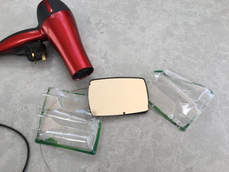

Morning all. As I get so much from this forum I thought I'd share a very basic but effective way of replacing wing mirror glass. I was pretty gutted to find one of my wing mirrors had succumbed to a tool falling on it from a shelf.
 I didn't want to stick a replacement on top so I heated it with a hair dryer on full heat and after a minute or so the glue gave way with some encouragement from a 2" filling knife.
As the backing plate wasn't damaged I've ordered a replacement which cost about £5.50 and hey presto job done!

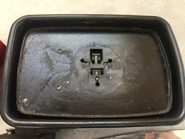

Ok quick update on this. The eBay replacement mirrors were poor as they're convex and don't perfectly fit. As I had one knackered old floppy mirror beyond repair I snipped the cables and pulled the mirror and backing plate out. The mirror did suffer a little chip so I swapped to using old plastic packaging to gently ease the mirror off.

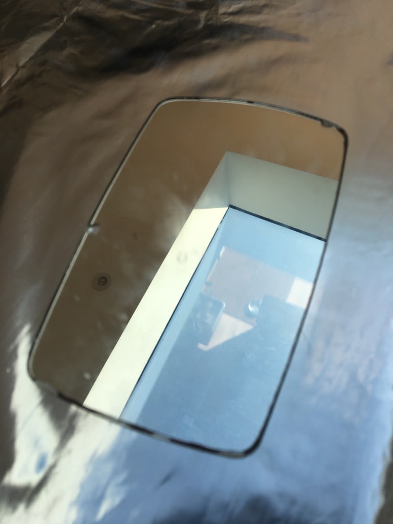

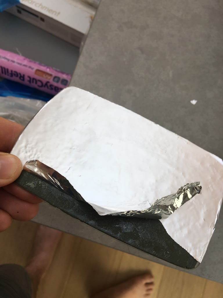

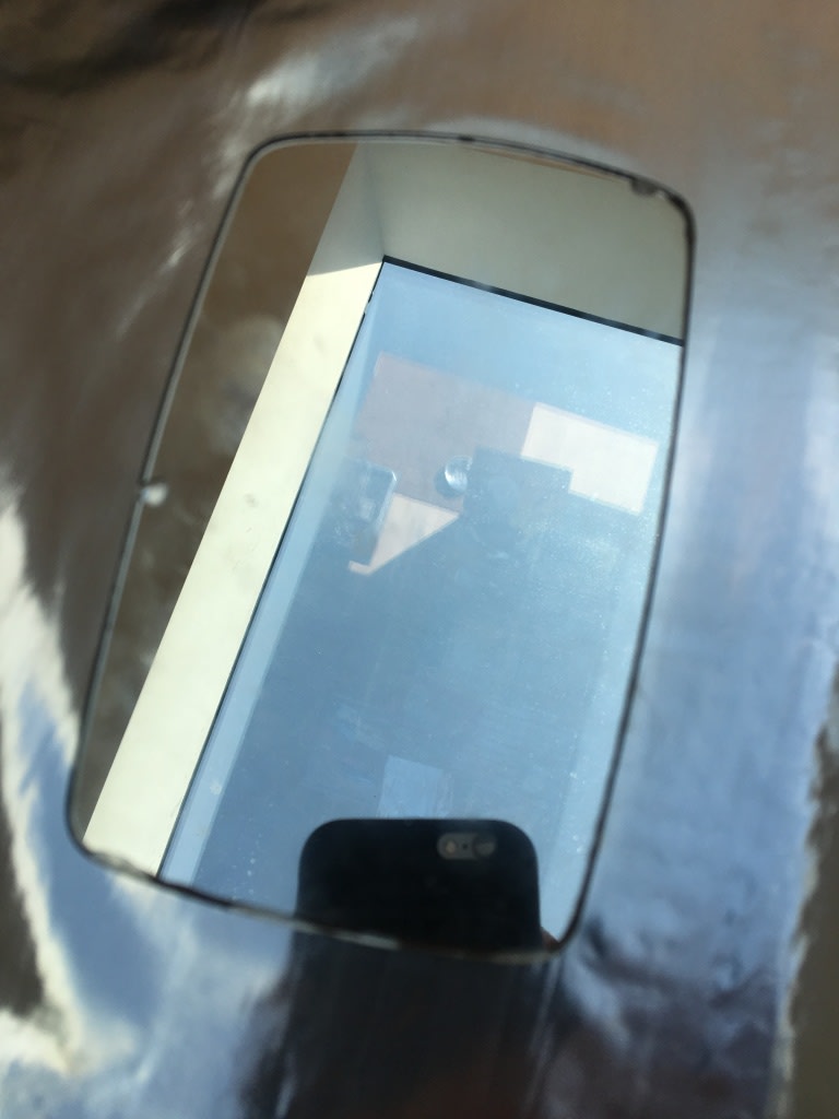

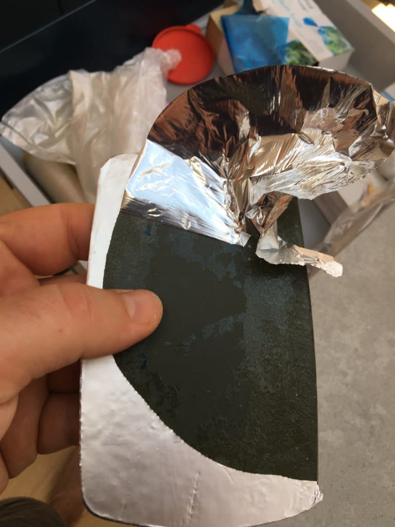

After removing the mirror and then the sticky double sided plastic I smoothed some tin foil with cardboard and then placed the mirror on it. As there was still adhesive on the back of the mirror it stuck. I then removed the excess to give me as much surface area as possible to reattach the mirror.
Not a perfect job by any means but certainly usable!
