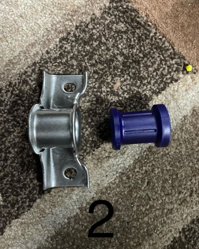

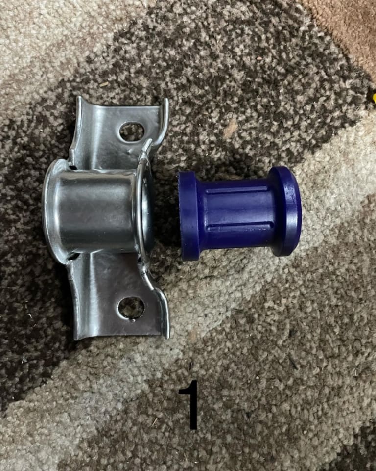

Probably should of pictured that before stripping them down!
Also once the bushes are in which hanger goes to which side? Flat edges of the hanger outer or inner?

They are super pro poly bushes, I agree I don't know if it would make a difference but I thought I'd ask before getting it wrong. 🤯
Briano1234 said
Insert the rounded end in to the mount on the right side of the mount in picture 1. Use Grease in the mount to ease the thing in.
I had a go and failed massively!
I used a threaded bar to pull them in but they refused and just squashed 😂

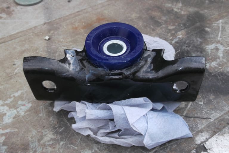

From memory the metal bush is removed from the polly first or you,ll never get it in, think they are bonded in the rubber ones but thats much more flexible..
abfmk1 said
Here is one i fitted a few years ago.
That explains the difficulty… Way to clarify.

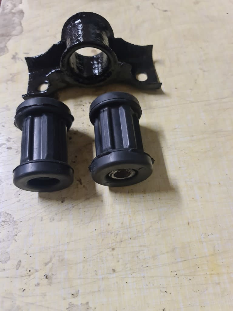

I can't remember where mine where from (I bought and fitted them when I first started my project back in the dawn of time!) but they were 2 piece so dead easy to fit!
