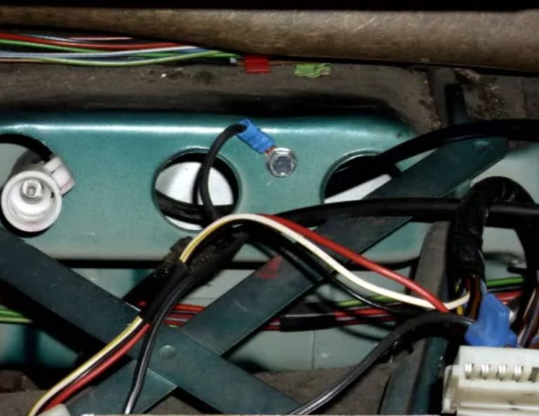

The Ground for the mfa is really from the
Right rear (as you look at the engine) valve cover corner to the Coil Bracket bolt.
If you want a good ground, then remove the cluster, and Drill a 1/8 hole on the inner firewall, sand down to bare metal about 1/4 of an inch around the hole.

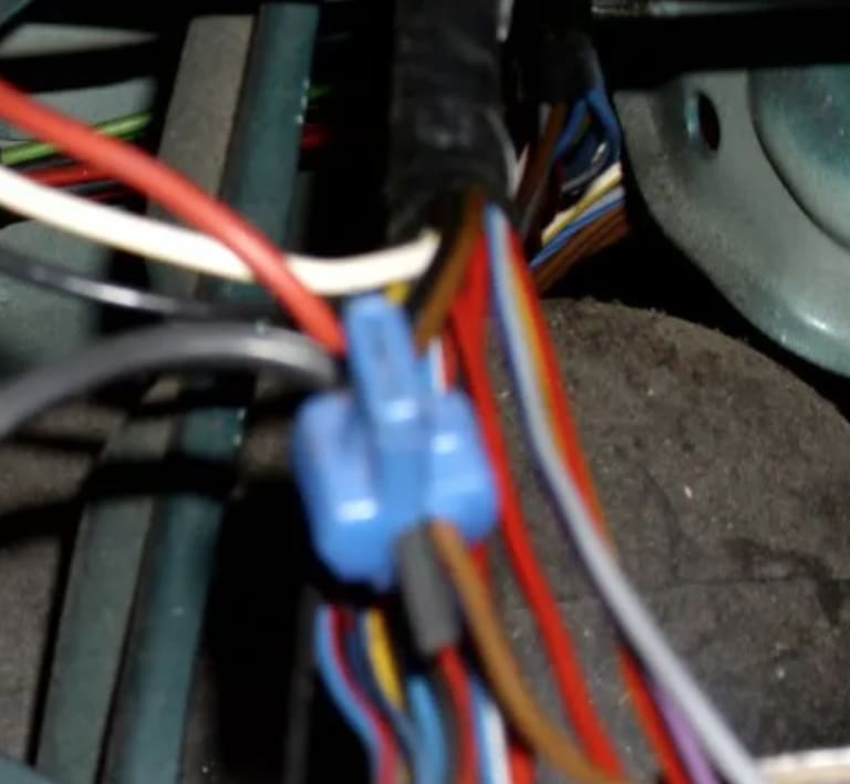

Using a ring connector and about a foot of wire attach the wire to the ring connector and crimp.  The Screw the ring connector to the firewall with a sheet metal screw.  The other end of the wire goes to the wire side of your main cluster connectors brown wire with a 3m Scotch-lok wire splice.
