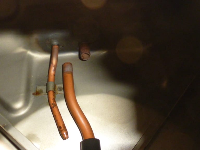

this was the pipe that connects the swirl pot to the fuel outlet inside the tank
you can see parts of the rubber connector pipe in the swirl pot. my fuel pump would get noisy when it sucked up air
