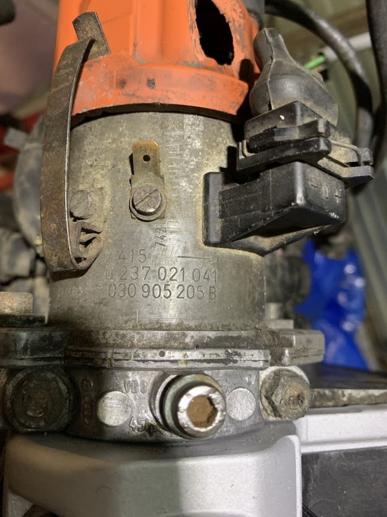

Couple of questions. I've swapped out the distributer that was on the car with the correct Polo mk2 distributer. I noticed that the distributer length is a good few CM longer now. What leads did you use, as the originals no longer reach.
Original Distributer:
New Distributer:
I have used a mechanical distributor in the past. I have Magnecor 45258 leads and they were long enough. I'm currently running the original AFH dizzy and controlling it with an MSD 6AL2 programmable ignition.

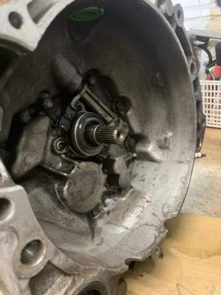

Fitting an 8p box to my AFH engine. To my knowledge, it's an AFH flywheel (it came with the engine) and definitely an AFH clutch. For some reason when the gearbox is fitted, the release bearing is tight and can't depress onto the clutch. Flywheel/clutch spins freely though. Any ideas?
Cheers,
Laurence
