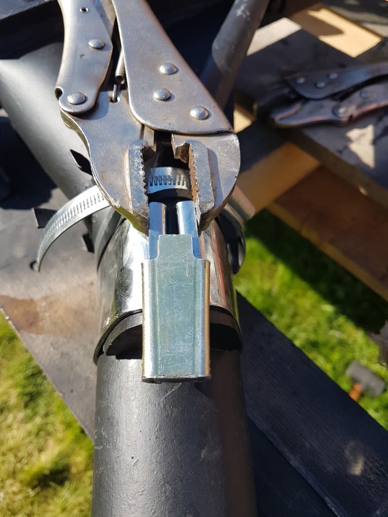

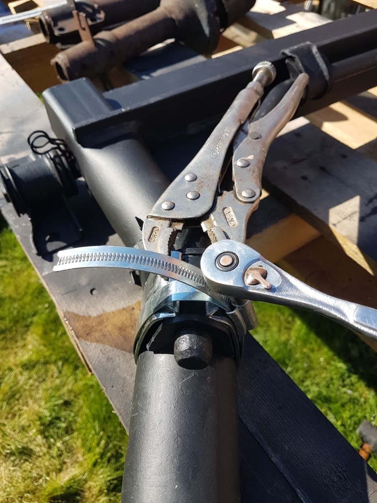

Thought would share some info and maybe use to someone else in future
Did read through older threads on this and mentioned using big hose clip or vice grips, I used both as when using just grips and tapping on tapered clip the grips can spring off and scare the ^^^^ out of you.
Also the threads had link to older thread which was empty.
Key is slow and steady - if tapered clip doesn't go on too easy start again - my first go there must have been a burr or something as clip jammed and scored big groove on inside edge and had to be filed flat before re-use.
Photos probably explain better - sorry, showing in reverse order!
