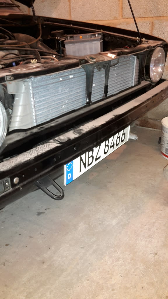

If you ditch the spotlights you could use a g60 corrado radiator with a merc sprinter intercooler.
Worked on my old g60 cabby pretty well, its a tight squeeze though.
As above I have g60 corrado rad and merc sprinter intercooler . Got rid of twin headlamps
