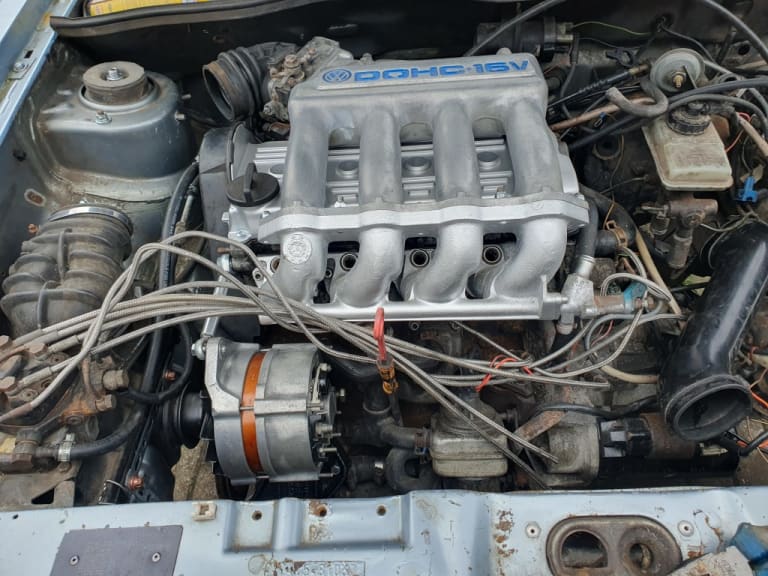

Long time ago since I started or posted on this thread so I thought I'd make a quick update.
Basically, I opted for the Mk3 2.0l 16v engine upgrade. Bought an engine and had it reconditioned, ported, polished and new cams. Keeping the Mk1 gearbox but it's been reconditioned too. Had a new loom made up, should be ready to plug and play!
Managed to pick up a clipper kit which will be getting installed after painting. Engine and gb has been in and fitted up.
Currently got engine bay stripped out getting prepped for paint, rest of the car will be getting prepped shortly too.
It's been slow but we're making progress! Will get some photos next time I get a chance. See you in another few years 😂
