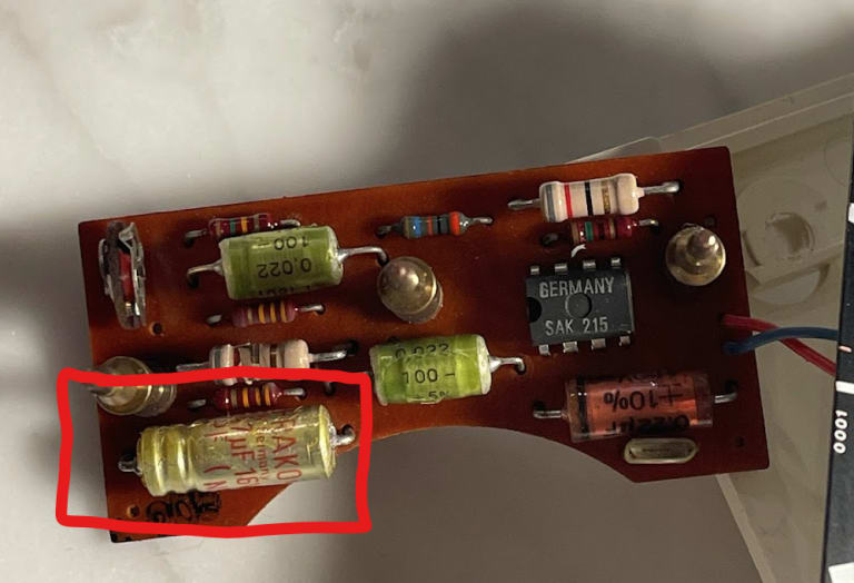

Try this if you have one that isn't working
I asked an electrical engineer who pointed out that one specific capacitor used on the board is electrolytic, meaning it is (or was) filled with a fluid that's probably dried out years ago. I replaced it and it worked! See the attached picture for which one to change.
I would guess that this is a common problem for tachs of this age, so I'm sure someone else will run in to it. A regular 47uF cap will work, any voltage rating above 16v. Modern ones are much higher so finding one shouldn't be an issue. Hope this helps someone out, thanks!
At these voltages you can use tantalum bead capacitors in place of electrolytic ones. That's what I've done on the few I've replaced (water temp guage, oil pressure buzzer board).
