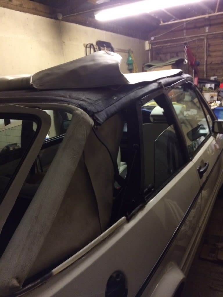

I'm looking for the side parts of the roof padding to stop the frame from showing/piecing the hood.
The hood looks like it has the padding around the rear screen but nothing on the top 2 sides.
Any ideas on what they are called and where I can get them & can they be fitted with out removing the hood?

The picture shows the frame pushing against the hood.
There is no padding between the hood and the frame, Is this correct?

I see what you mean.
There is no extra side bits which cover there as the pad underneath the roof skin is 1 big piece which covers the top.
Your roof looks new and I'm surprised who ever fitted it did not replace the pad?

The padding coverlet goes under the padding, it supports the padding off the cross bars and frame bits.
The newer style padding kits are all vinyl on the bottoms  and sides.
The horse hair is like:
You center the padding. then wrap the sides up and over
Staple the coverlet at the rear bar, and glue at the front.
I also glue the over lap.
what it looks like al smooth.

The pad is there to smooth out and insulate the roof so there should be one under there however it doesn't go down past the last bow at the rear or extend over the sides of the roofs.
