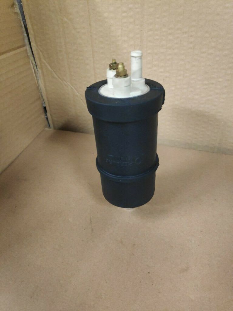

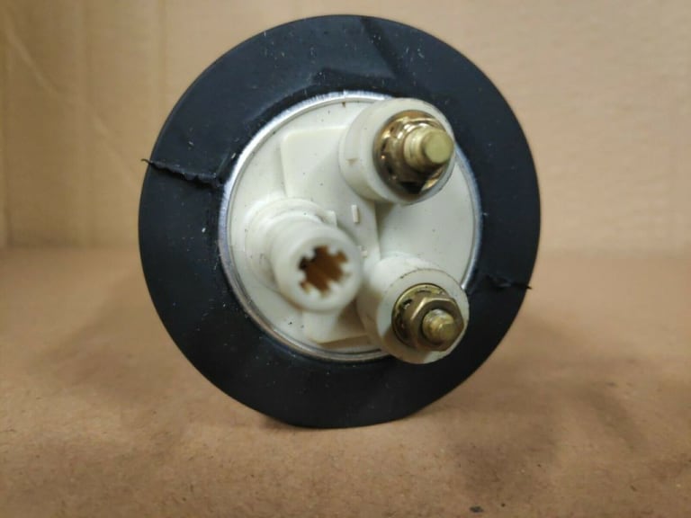

Hi Just to let you know my Young Line is all sorted, I took a gamble on a pump that was marketed as not for my car, but after I took the rubber protector off the pump it fitted perfectly in the bracket under the car and works really well! FYI it is a Pierburg 7.21287.53. thanks for all you help, Cheers
