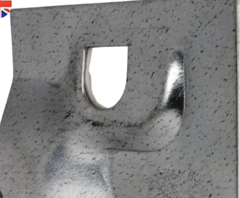

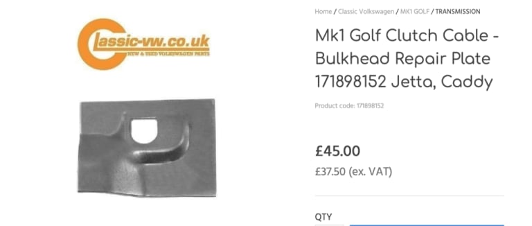

Never drove a RHD, so I can't help you there but there are mender plates and how to's on the firewall feed through and clutch tube which may be suspect.
