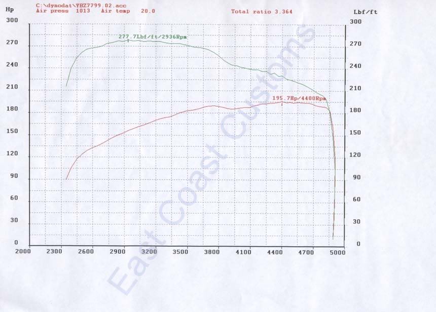

The only thing that comes close to it on torque, would be a modern diesel with lots of electronic gizmos, etc.
LOL!!!, my 90bhp Seat Leon this morning on the RR!!
Still a bit of tweaking to do though!!
Must be nice having 100bhp at 2500rpm!
