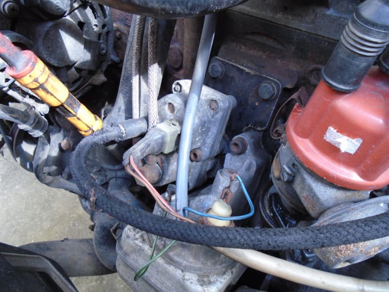

You can make your own blanking plate for the breather on the block and the WUR will fit there, see photo.
