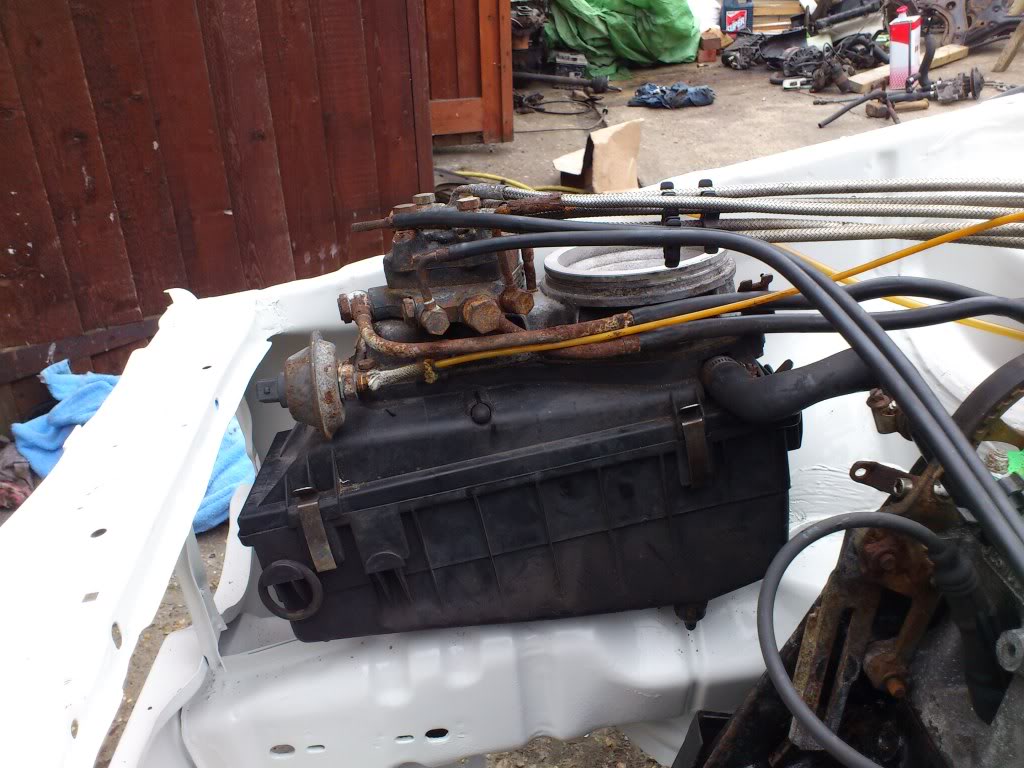

i have 1 problem i am not sure wot to do with and wondered if anyone on here can help me
this is the problem
wot can i do with this so my bonnet will shut wen i put it bk on lol
cheers spides
Cut down the airbox so its much lower.
Or use a Mk1 airbox, with a slot cut in the bottom of it (not sure if thats a Mk1 or mk2 airbox you have there).
its a mk2 airbox on it at the moment didnt know if a mk1 airbox was different tbh will have a look for 1 want to get it running this week :D
cheers :D
Can't you put a Mk1 inlet manifold on it and then use the Mk1 air box as a normal Mk1 GTI ?
just cut the bottom out of it, since that is what you have. no need to spend any more money! this is what my mk2 16v airbox looked like when i was done making it fit:

cheers mate will cut mine down so it fits :D
