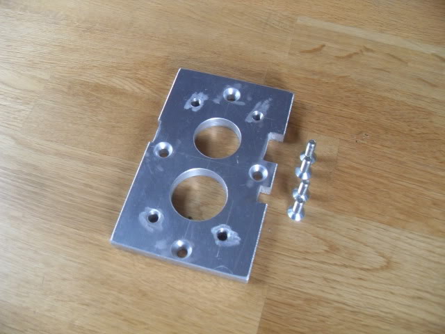

I will use a weber 32/36 dgav on my original 1,6 intake for my scirocco -1976 and would gladly see how you have done your adapters? Aluminum? Iron? Thickness?
Thanks!
/Tommy
Golf 1,6 GTI 1979
looking for inspiration to build a plate for themselves!

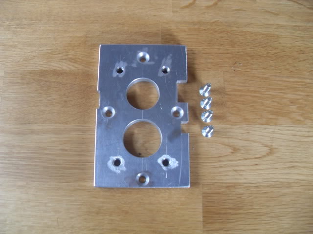

I used a 10mm aluminum piece anyway, a clear advantage is to have access to large drills! Otherwise there is no problem

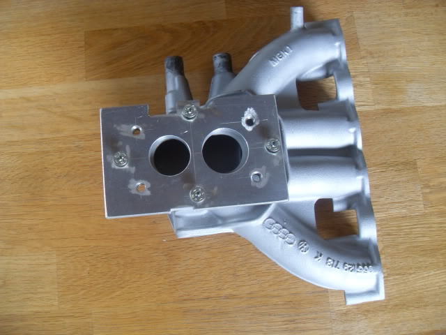

It's made to fit the intake manifold on a regular 1.6 carbureted engine like EM,FN…
And the Weber I made the plate to is a 32/36 DGAV from a Ford Granada from 1982.
The plate on the intake manifold, as you see, you have to remove some matrial in the holes on the intake.
