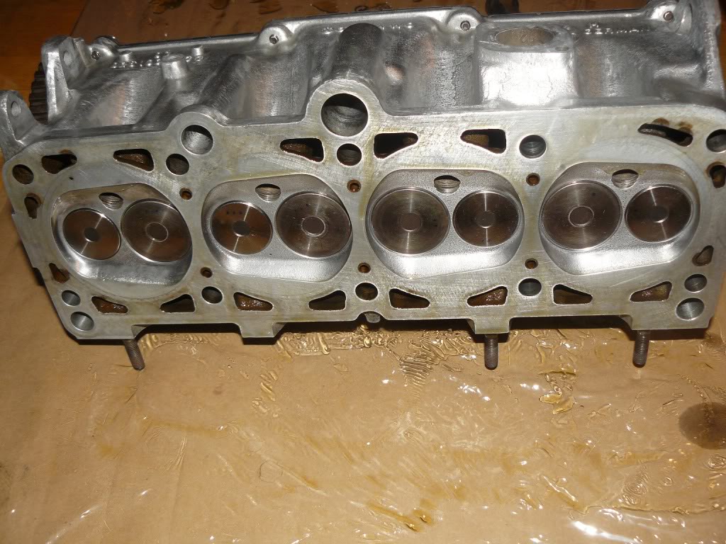

I'm putting an engine together to fit my rabbit mk1, but lately I got a little confused.. About combustion chamber, pistons and compression.
I'm using the golf mkIII/passat bII/bIII bottom end AGG of 1984cc and longer stroke, known as a tall block. Together with the block I planned to use a hydraulic engine head with 40/33mm valves, ported and a 276 degree camshaft. (I'm not sure, but the head is probably late mk1 gti or mk2 gti).
But when I came to think about the compression ratio I got the idea that the combustion chamber will be too large, with low compression as a result.. ? This because of the pistons with a lower part in the centre (see photos) combined with a head with combustion chambers..
Does anyone know for sure what I will get in compression ratio? Or is the an easy method to get the exact numbers? Cause I don't intend to build a supercharged engine, I would rather have compression around 10:1 or so. I've been told that the AGG originally comes with 9,6:1
But skimming the engine head could cause disaster not knowing the present compression ratio.
Pretty please, put your clever heads together
The cylinder with piston in top position
The engine head combustion chambers

The compression ratio and displacement of both engines to start with.
From that, you can work out the combustion chamber volumes.
For instance, 1781cc total displacement.
CR@10:1
Number of cylinders=4
So, 1781/4= 445.25 cc per cylinder.
CR=VS +VC/VC (vs is swept volume, Vc is clearance or chamber volume).
So, 445.25 + 49/49 =10.086
Cr = what we know it should be for the example given at 10:1, so the chamber volume must be? 49 cc.
That includes, the head volume, the piston dish volume and the gasket volume.
If you change the VC number ( 49 in this case upwards) the cr goes down in the calc and vice versa.
You can work out total engine volume from this as well.
1781+49 X 4=(196) =1977 total engine volume.
Other way to do it is to physically measure the volumes of the chambers, the voulmes of the bowls in the pistons, the head gasket volumes and do it that way.
My main concern though is the two photographs, maybe they are an optical illusion, but are not the pistons going to hit the cylinder head when it is installed, there does not seem to be any clearance in the head when the pistons are at TDC.
I noticed the raised section on the piston also.
Needs to do physical checks on piston to valve and piston to head clearance and make sure the piston has at least 50 thou clearance at tdc, otherwise its likely to say "hiya!" to the head or valves or both.
Malcolm, there's a little optical illusion, the "heel" of the piston is even to the cylinder top, then the multilayer steel gasket is pretty thick. The engine bottom and the pistons are both standard and built together in the original AGG-engine. Nothing is altered so it "has to" work.. hehe..
I'll try to measure the volume of the combustion chambers in the engine head. Can I do it with a piece of glass/lexan or whatever with a hole to pour fluid into the head. I just need to find a vessel with ml or smaller grades.

I tried to measure the total CC today with a pump and a plate of glass.
Theese are the numbers i got
total volume 1984cc
Bore: 82,5
stroke: 92,8
volume of piston dish: 20cc
volume of engine head: 29cc
volume of gasket: 11cc
Total combustion chamber: 60cc
1984/4 = 496
496 + 60 / 60 = 9,2666 = CR = 9,26:1
Which is far to low.. the original CR in AGG engine is 9,6:1
So how much should I skim the engine head to come to somewhere between 10:1 and 11:1 ? Will be run on 98 oktane fuel only.
