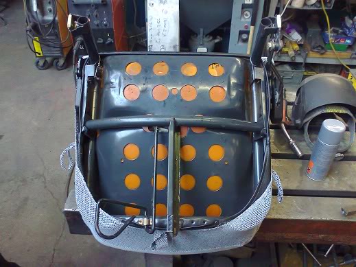

after much head scratching i decided to strip original seats and remove what i needed to do this conversion
i then welded some steel bar onto the runners so i could removed what i needed but keep it all in shape and lined up correctly
i then stripped ignis seat as much as i could and cut of its runners,
forgot to take a pic before i chopped away but heres what i had after wards, had to leave cussion on for now to keep the seats shape
i then placed the bits from mk1 frame onto ignis frame to see what else was needed
then after final trimming and cutting and bending it lined up as i wanted it
then it was just a case of welding it all up

then obviously do the second seat and measure it all up so there the same height and position when refitted
ignis seat belt thing on the right and golf one on the left
golf seat belt thing bend and shaped so its the same fitting as the ignis one
bolted to the seats and cusions refitted
both seats reassembled and ready to be fitted back into my golf
and here it is the finished product in place and looking great if i do say so myself
just the back seats to takle now and recover them to match ..
the ignis sport rear seat is just plain black but it does have matching head rests so a bit of work to do on the back too …
hope this helps anyone thinking of doing the same type of conversion because this method would work with any seats
