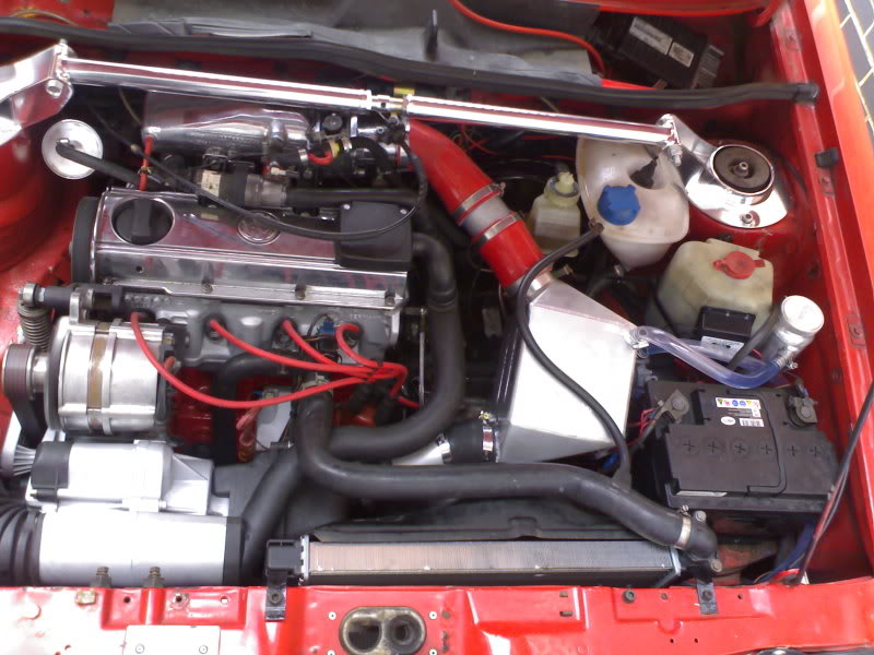

I have just had this conversion done to my Mk1 by Midland VW - very pleased with the outcome !!
This is what they used:-
Golf Rallye Engine, G60 charger and ECU, - Full strip and rebuild of engine and charger, it was already chipped and had the smaller pulley.
MK2 Golf 16V gearbox - this was fully stripped and rebuilt,
Radtec Radiator and intercooler - specifically designed to fit a G60 in a MK1
Supersprint stainless 4 branch exhaust - cast manifold found to be too restrictive - Lambda probe added to downpipe.
16V MK2 clocks - because my Mk1 clocks were knackered and these are easy to get hold of - they take some time to make fit properly though as the mountings are totally different.
It goes in for its 1000 mile checkup next weekend, so looking forward to see want power it is putting out on the rolling road :-)

radtec setup is great perfect fit, i would use the mk2 16v box with new seals and bearings, if you need any help or would like me to do the job i am more than willing to just pm or ring :wink:
you won't be dissapointed with the end product
