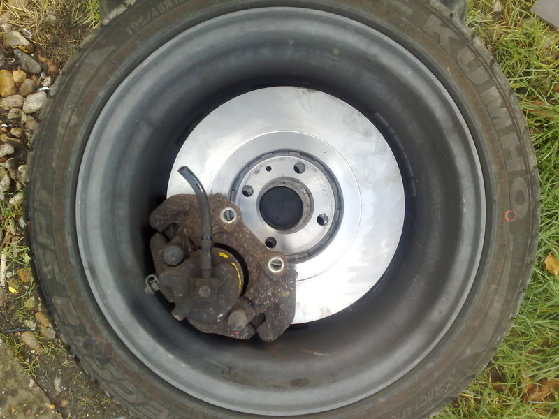

no im half way through couldnt get the wheels on  :oops: need some spacers :mrgreen:
How much spacer do you need? Do you think you could grind the calliper so that the wheel fits over it? Like i did on my friends mk4 R32 with audi RS4 brakes and 18" wheels.Yes i ground down the ?1200 callipers with a die grinder! Scary shit!
Problem with the ATS cup is they are a backwards wheel.To briefly explain the well of the wheel used to fit/remove tyres is near the inside rim rather than the usual outside rim,so you have the wheel upside down when fitting tyres.Most wheels are the outside up when fitting tyres,this makes the inner diameter of the cups much smaller than most usual alloys

im not using g60 calipers my set up is
g60 discs
vectra calipers
bolts from chrismk1van
and they dont fit under ats cups even with 20mm spacers :mrgreen:

M7R i know what you mean about spacers ive made a bit of a change to my set up now going to use 16v discs and vaux calipers to match so one size down
as i want to keep the 15s tbh it handles very well as is so dont want to ruin it by sticking 16s on the car
my car has 15" intra alloys that are a very similar shape to ats cups, i've converted to the 280mm set up from the corrado but i had to grind a hell of a lot off the callipers. The brakes seem to work fine i used them very gingerly at first and gradually got the confidence to give em some pasty and they seem fine but i should probably test them on a proper brake tester
i didnt want to grind them tbh as i would have been to take alot off :lol:  plus the last thing i want is a caliper to snap when im trying to stop from warp 9 :lol:
had a moment at santapod where i didnt think id make the exit road but did and my brakes were awful after and even worse now

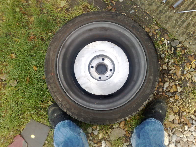

the ats cups are a weird wheel ill get a pic at the weekend of the inside so you can all see they taper in loads near bolting face weird :dontknow:
heres a pic look for the wheel wieghts this gives you the idea of how tight they get lol
