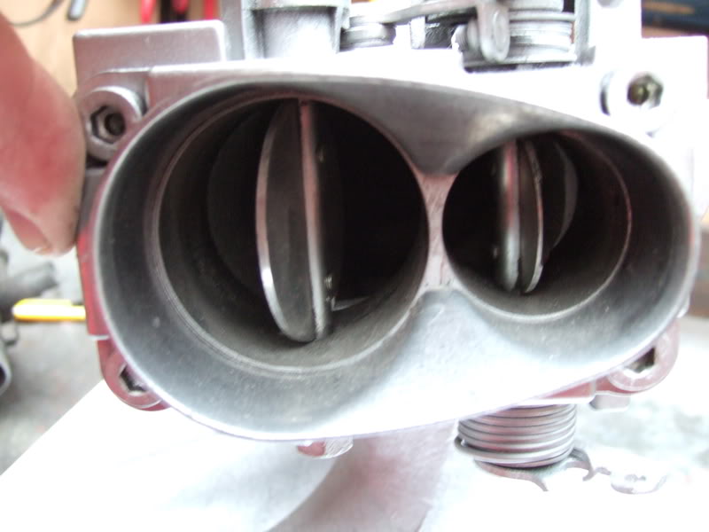

The butterflies will foul on the inlet manifold if you just bolt it on. It'll fit but you won't get full throttle. You need to open up the mounting face / inlet area of the manifold with a dremel

soooo… to get the full effect you need to open up the inlet fanimold (without letting too much grit, waste ali grindings fall into engine), fit a audi WUR and vac pipery. Not quite as simple as simply bolting on a TB.

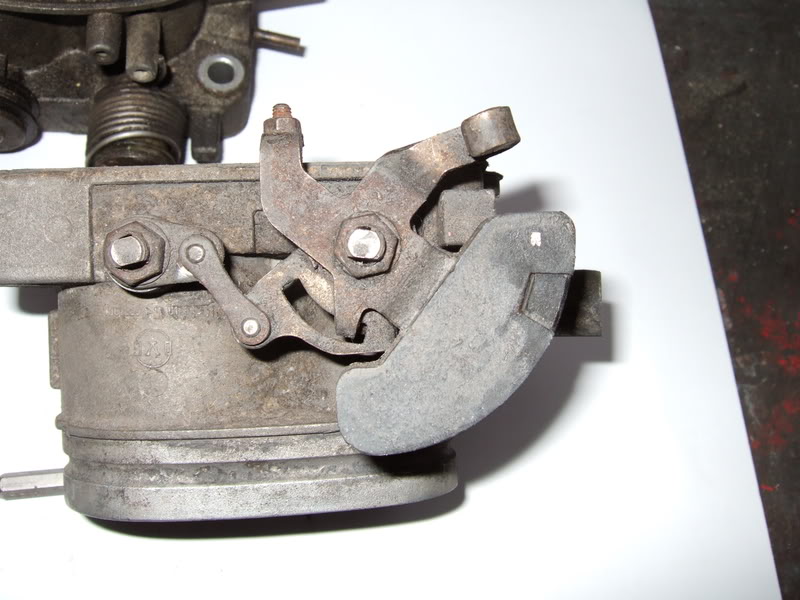

Linkage differences
Welded mK1 throttle cable item
Audi item fitted after porting the original item to fit
Finished item blasted and painted ready to fit

As for modding the inlet manifold, make a paper gasket that fits the throttle body mounting face then place that on the manifold. Dust with a paint aerosol and that'll tell you what metal needs to be removed. Alternatively bolt the TB to the mani, partially open the butterflies (can't open fully - it'll foul !), and scribe marks on the manifold mounting face.
For reference here's an Audi TB loosly mounted on the Gti manifold. Note the mounting face of the manifold visable through the TB :
And here's an opened up Mk1 manifold so as to accept the Audi TB :
