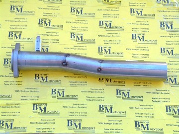

is this
this two pieces set with OEM other exhaust system,is it?
