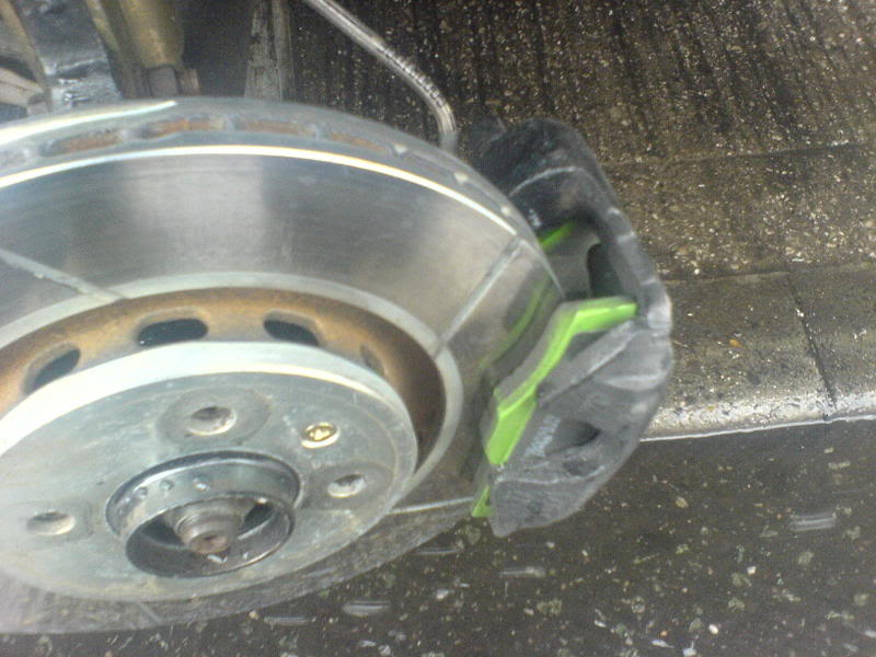

they came to me like this. brand new hubs, wheel bearings, discs, pads, calipers and the caliper extension bracket. fully built up out the box
pic after i fitted them on saturday
well anyway i've done about 40 miles max since sunday, drove back from heywood to my house (20 miles) and to work and back since monday.
Driving back from work today, just come off the motorway onto a dual carrigeway about 2 minutes from home when the sound of a bolt twatting some metal happens and an almighty knocking happens, so i pull over calmly into the bus stop without braking as i only doing about 20mph when this happened. Once i got into the bus stop the o/s wheel was seized up to fuck and the car just stopped straight away

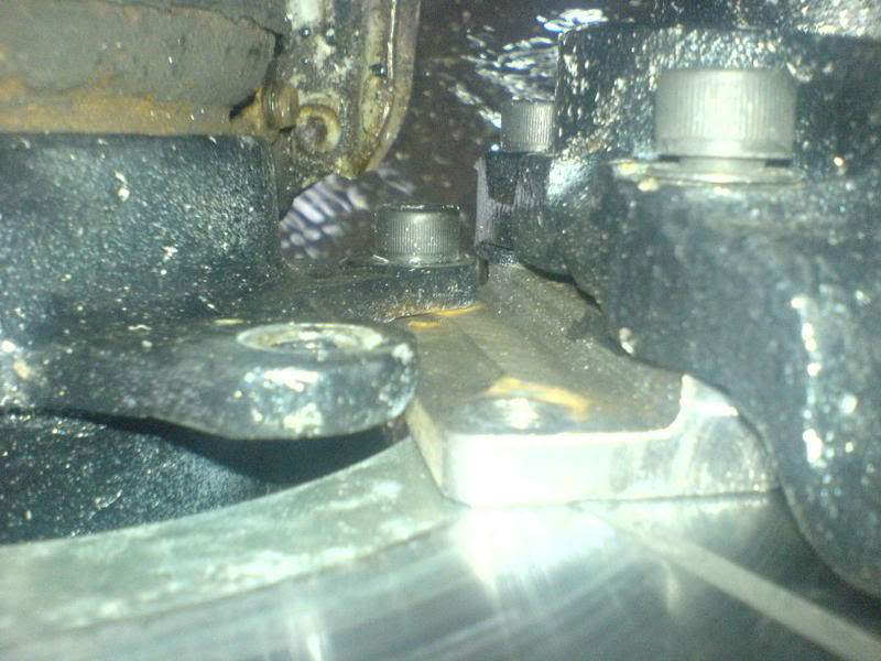

jacked up the wheel to find to my dismay that one of the caliper extension bracket bolts had either come loose or sheered out of the mounting and my caliper was hanging by only one bolt.
it had essentially cheesewedged itself against the brake disc and my alloy wheel
i tried to find the bolt in vain, but i managed to take some pictures, you can see the missing bolt, and the bolt thats holding the bracket to the caliper is also coming losoe.
These bolts were torque wrenched tight when fitted to the car but needed no real tightening as they were proper tight out of the box.
I either suspect that they were hi-tensile bolts used or they werent held in with loctite when originally fitted by the company who sold them to me, surely these bolts shouldn't come loose and disappear completely after only 40 miles of driving.
I'm not impressed in the slightest and the fact that after only 40 miles this has happened, how the hell am i meant to put my faith in these brackets indefinatly, as i had planned on keeping these on the car for as long as she lived. I mean imagine if that had happened round a roundabout or when i was doing an emergency stop.
anyone else had similar problems, or are you still running your 280mm brakes years on with no problems?

The normal carriers have a plain hole, the hub is threaded. So the bolt torques by pulling the two together. (All std Cap Head Socket Screws are high tensile).
How do your brackets mount to the hub? Have the threads in the hub mounting holes been drilled out? If not then the design is completely screwed, torqueing the bolt will just tighten the head against the hub, not tighten the bracket to the hub.
from that TSR image it looks like they bolt to the hub differently from yours, they use countersunk bolts to bolt into the thread of the hub from the disc side which makes more sense. Countersunk into the bracket to clear the disc once on.
On another note, there should be no need to loctite them, carrier bolts aren't loctited as std. The torque should take care of that. If they are torqued, the only thing I can think of is false torqueing, from either, crap liquids, grease etc in the threads, or incorrectly formed threads in the Bracket. As you said though, all new parts and you did check em, so don;t know whats goen wrong there

hi yes they are high tensile bolts and it has sheared from being over tightend you can give me a ring in work on 01656 6***** i would just like to ad that we have sold hundreds of these kits and this is the first one we have had a problem with

I thought the bolt is missing? If sheared you'd have the stub of it still in the bracket.

I'm confused by those brackets….
Spot on there mate.
What material are the brackets? They look like Aluminium, if they are they could be partially to blame as heat would cause different rates of expansion, potentially loosening the bolt.
