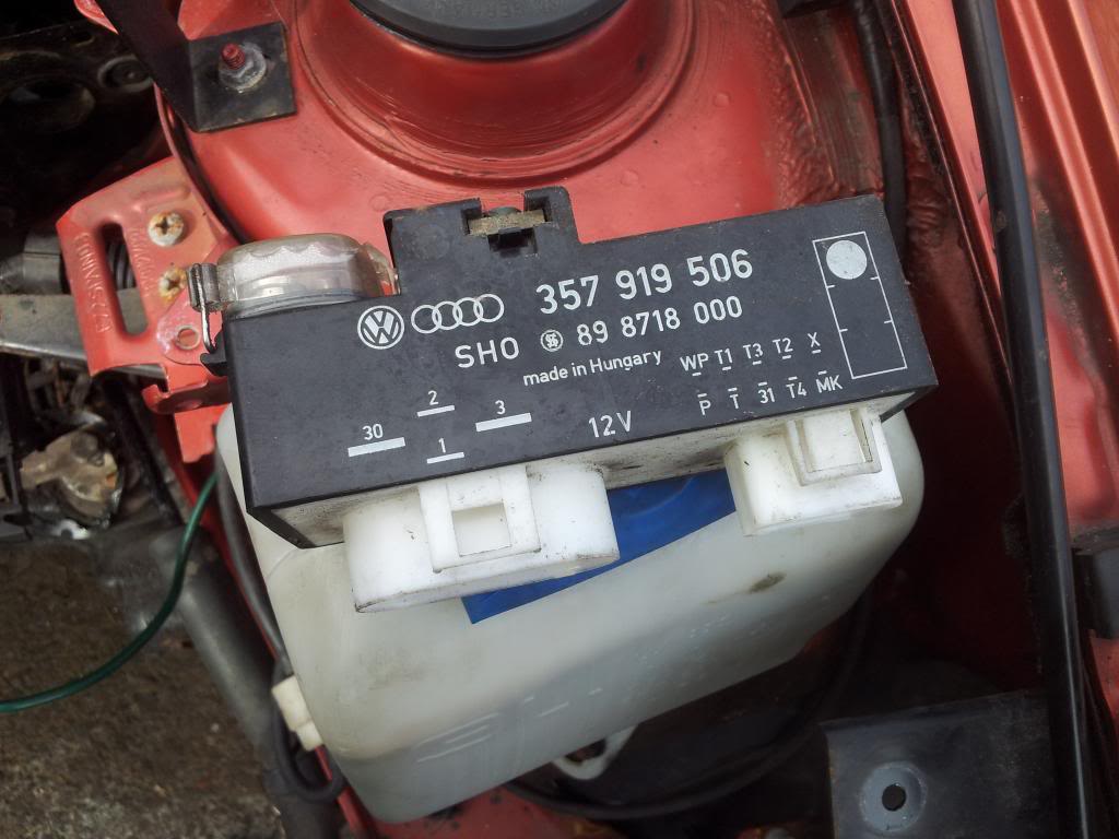

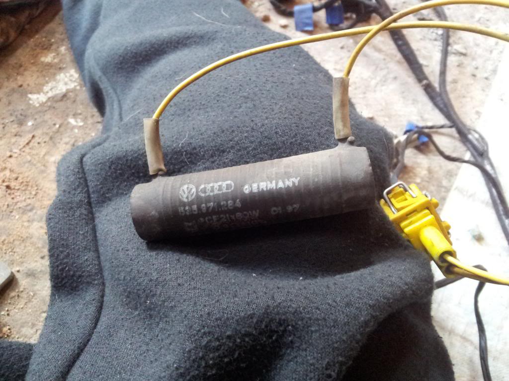

2 more things to double check before taking them off the ABF loom
Should I be binning these 2 things below? Also when these 2 things are sorted I will have finished stripping the ABF loom, just looking for some advice on the next step. I'm putting a whole new loom into the mk1 so this is on the floor, should I start to link the ABF to the new loom whilst on the floor or should I fit the MK1 loom first then splice the ABF loom in.

1. dimdip resistor -> bin
2. fan+a/c controller, keep if you want but I bin it and just use the old mk1/2 fan + wiring
