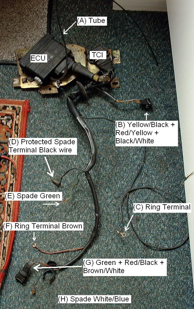

http://img.photobucket.com/albums/v519/mk1dubdriver/Mk1/Harness2B.jpg
Start with the ECU/TCI. Really, use the image cero posted, make sure you have that connected up correctly.

Yes you've missed something. If you haven't missed any wiring, it would be running. But….I don't know what you're missing. Best thing would be pics of each part, with cleaned up wires so people can see the colour codes too. For instance you don't mention the TCI - it will need to be connected to work! Hall sender? Coil? etc.
