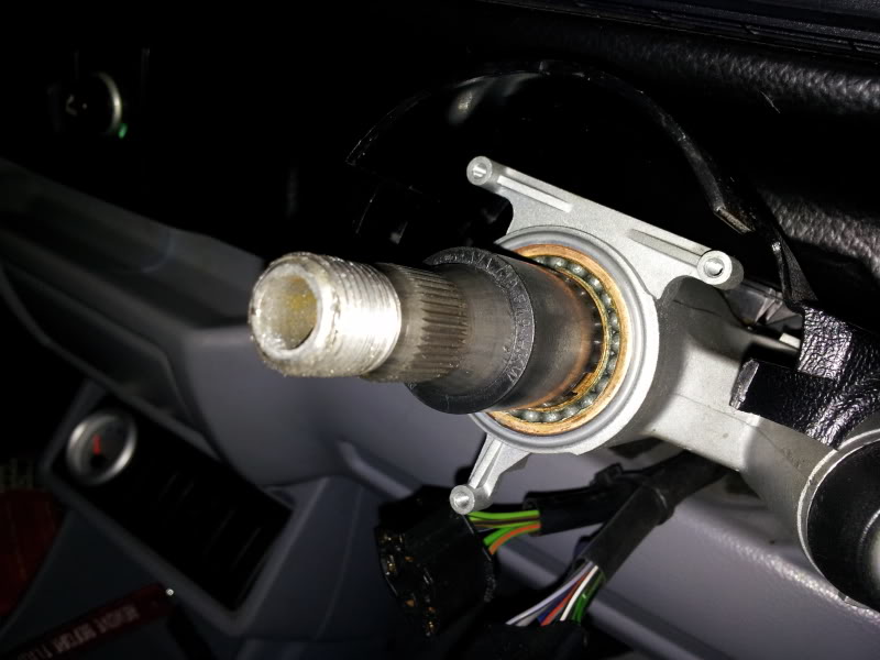

I just bought a steering wheel and boss kit for my mk1 however the splines are too big to fit my column which I think is 17mm ? I do have a spare column which has I think 30mm splines, Can someone tell me on the larger column is this just an adaptor that is fitted over the smaller type splines and could I remove it and put it on the column which is already fitted on the car ? Thus giving me the option of fitting my new wheel ? Also are these adaptors easy to remove ? is it just the metal part I need to add or is there something else and do you just tighten the nut down to push it into place? I know im asking a lot of questions but any advice would be much appreciated, Thanks in advance guys, Cheers Carl.

It dunt fit

Then you need plastic spacer from vw from early car.
The part number is in one of my posts. Ill have a look.

Hope this helps.
