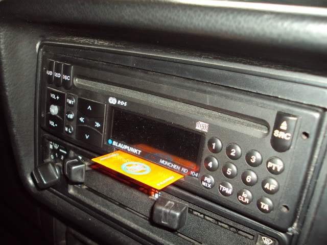

Mine's not original but I think it looks the part:
It sits flush with the heater panel beneath it. I think the SONY tape deck units that were about at the time/fitted in early Mk3's stick out a bit further.
Yeah that looks really nice.
