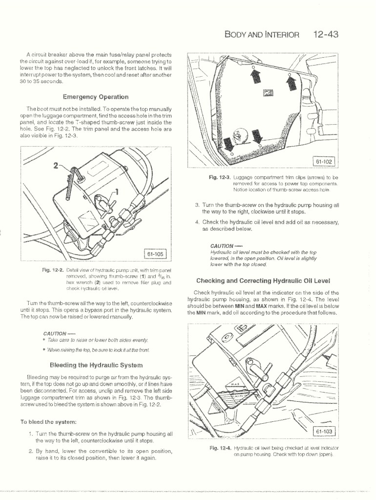

Make sure fluid is checked with the roof in the down position.

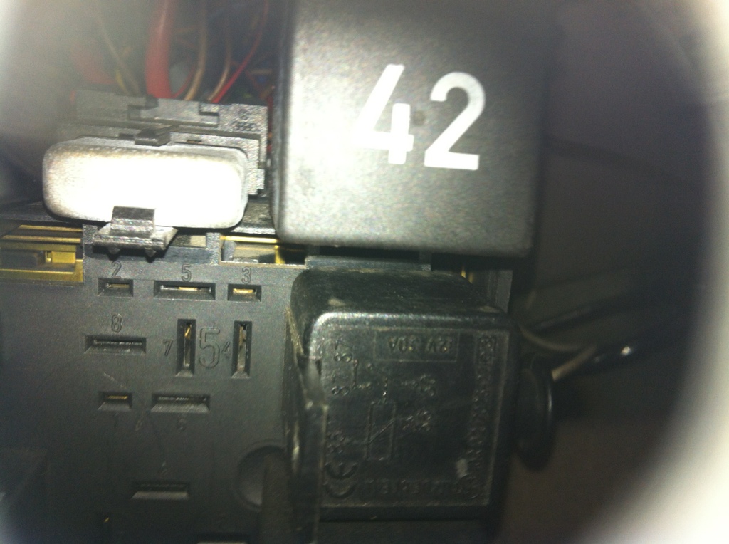

Hi ive tried all of the options. all I can see above the  fuse box are various relays 2 blade fuses and a odd silver slimmish thing that may or may not be some kind of fuse (thermal or otherwise) right at the end. do they just pull out or is there a knack to removing relays and the odd fuse thing
the roof had worked perfectly fine up until yesterday
The silver thinnish things are the thermo fuses. If you have 2 one is for the power windows.

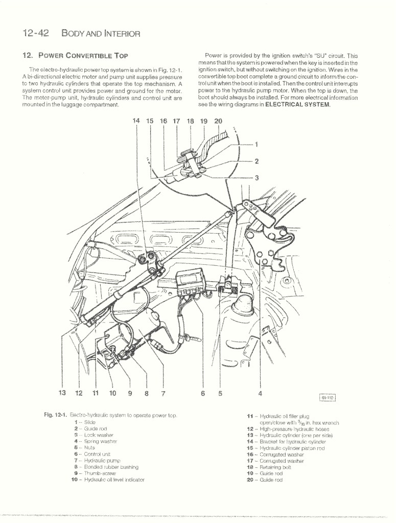

Have a look at this.

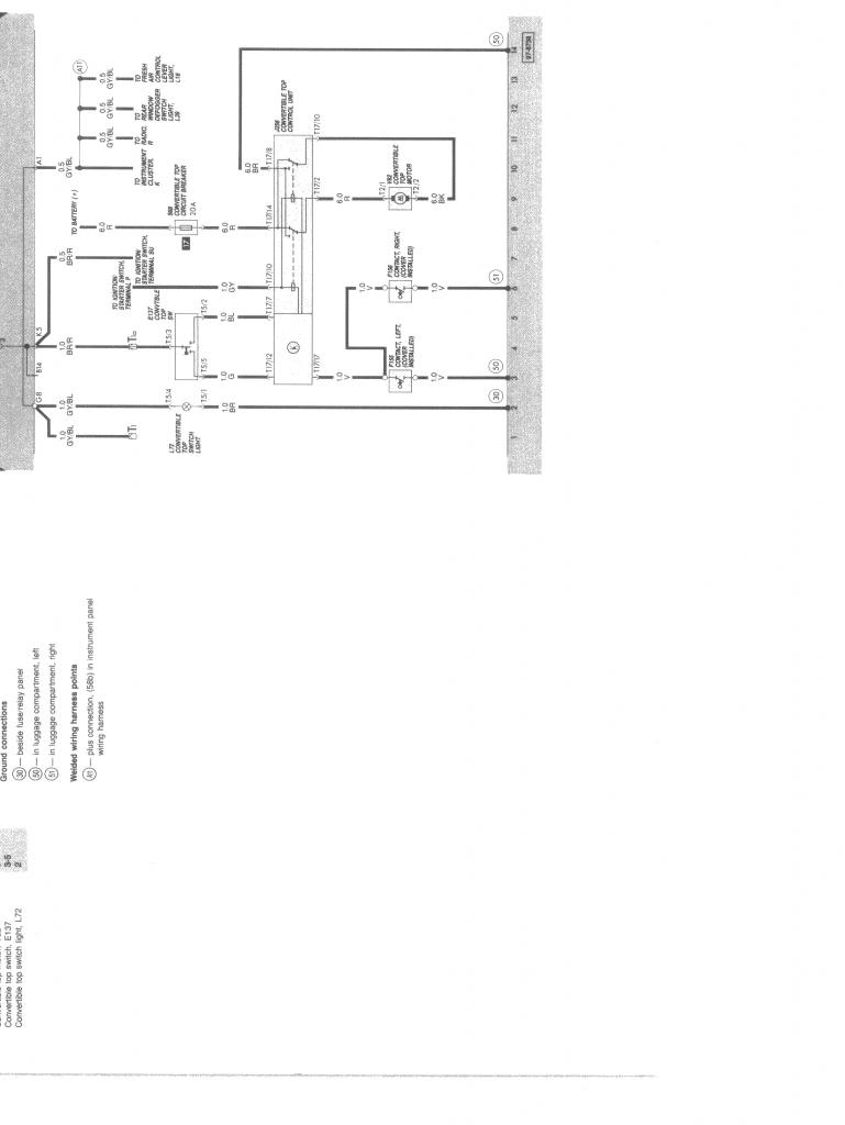

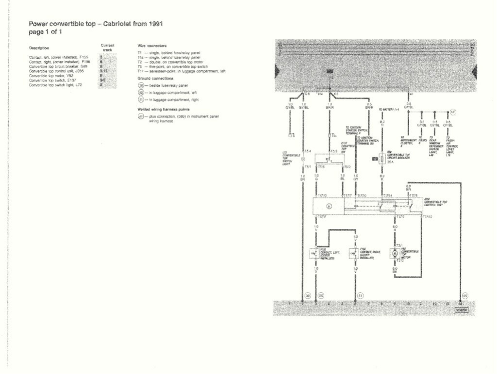

It looks like power comes via ign switch terminal SU and also at terminal P to control unit in back of boot.
Supply from battery is via thermo fuse at top of fuse box 17 20amp, then onto control unit which is in the back of the boot.

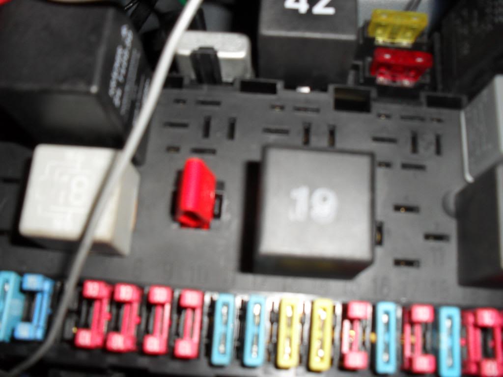

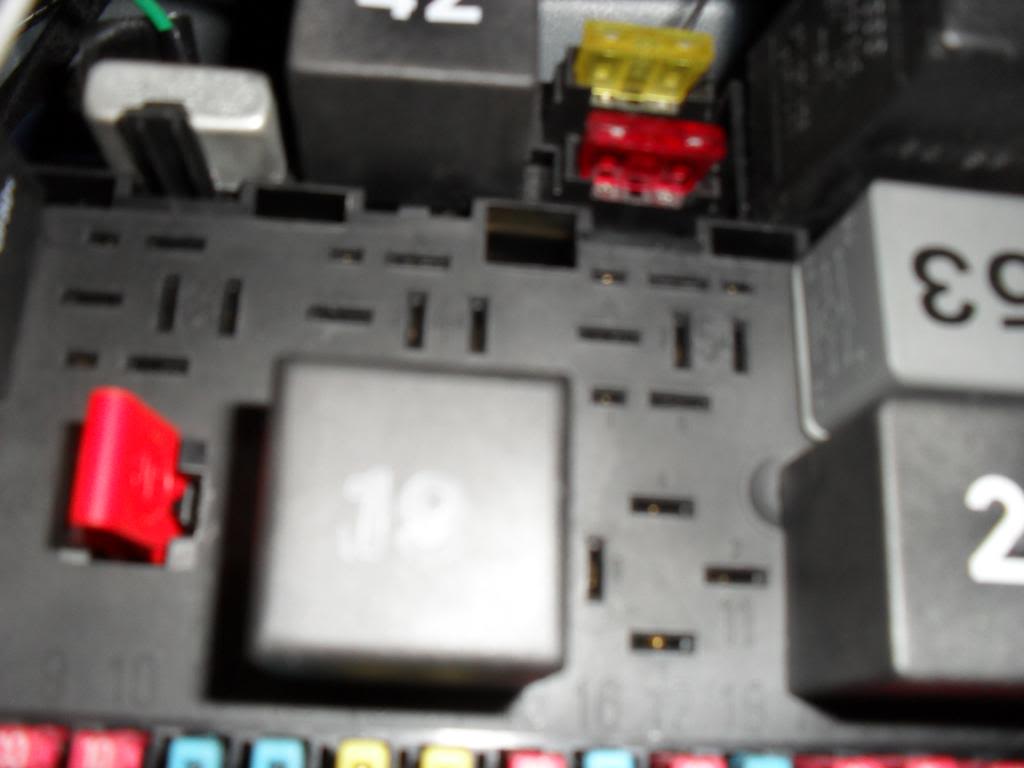

Hi I've found a thermal fuse and its completely in the wrong place (not in position 17 if i'm looking correctly) I do however have 2 blade fuses where a believe postion 17 should be between a couple of relays and they are fine. not sure if someone fitted a blade fuse instead of a thermal one. I'm no auto sparky but I cant see anything obvious. I may have to take it to an expert because i'm lost now any chance of a photo of your fuse box to see if its the same as mine (sames fuse relays etc)

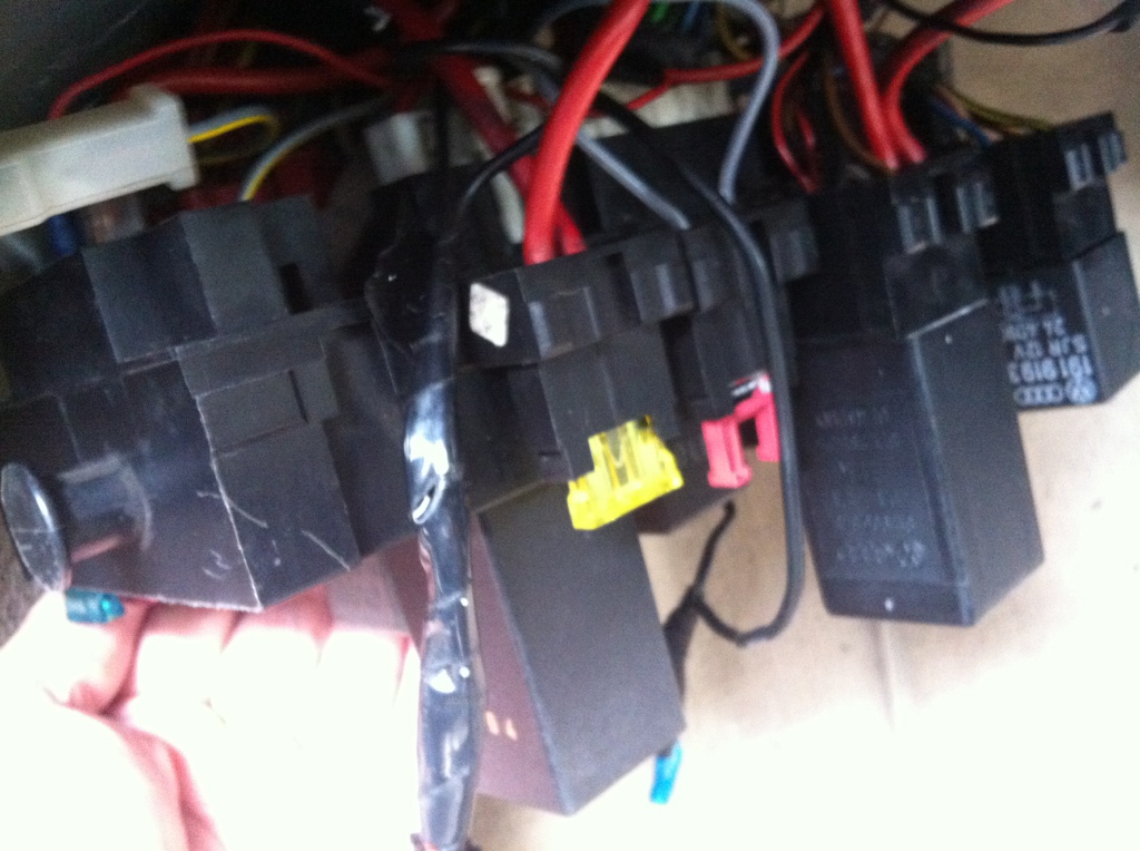

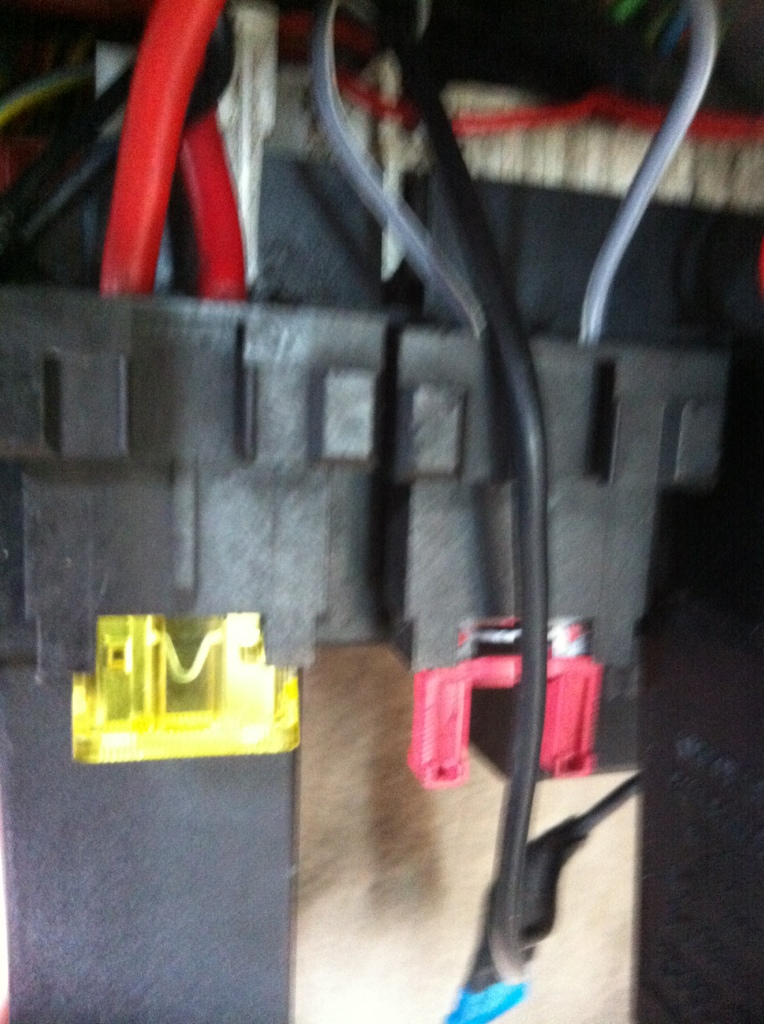

had a good look and found took out the silver thermo fuse cleaned up the contacts etc but no use still not working your fuse box appears to slightly different to mine

the thermo fuse is in a different place but seeing as theres only one……I still need to get the multimeter on it and check after that too be honest my expertise runs out
Yes it's confusing as I took the info from the Bentley manual, so there were slight changes in years.
I pulled up 1991 as that was my year of car, don't think there was that much difference for later models.
