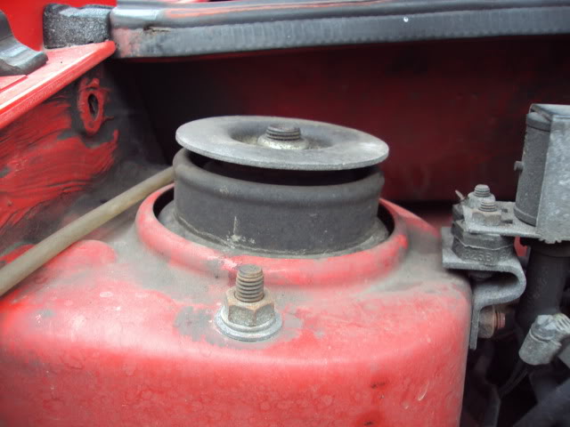

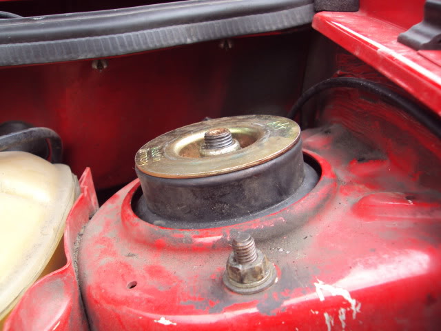

Had this with mine (also late cabriolet) and have just replaced the top mounts and bump stops, which have made it a hell of a lot better.
Here's before:
And after:
There's still a bit of a noise over rough ground and after another check I've found a bit of play in the ball joints. I'm replacing them this weekend so watch this space…
