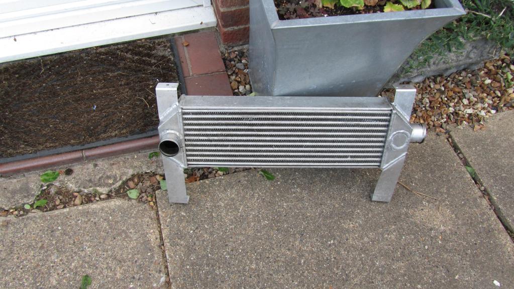

I did a bit of research and considered the Pro Alloy custom route which would obviously be £££ but plumped for this in the end off Ebay.   http://www.ebay.co.uk/itm/230879020680?ssPageName=STRK:MEWNX:IT&_trksid=p3984.m1497.l2649

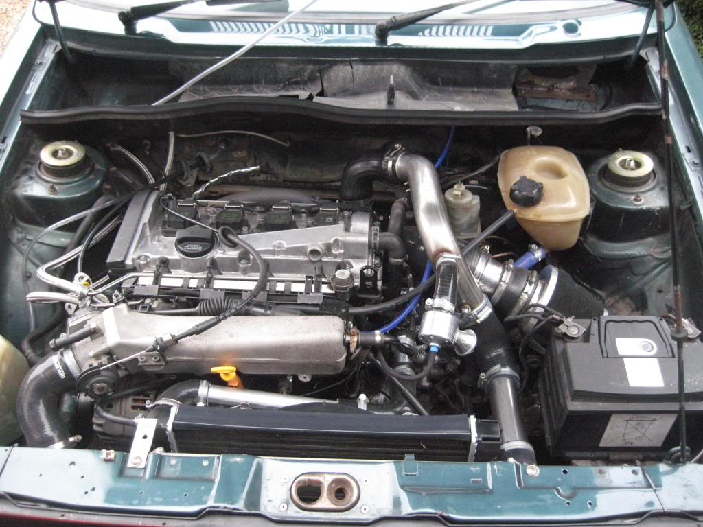

Yeah I see the attraction with front mounted ones but I am going for the subtle OEM look so will be mounting it on the inside.

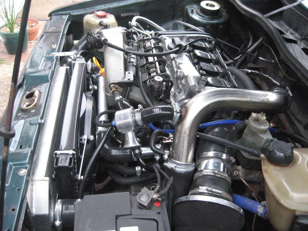

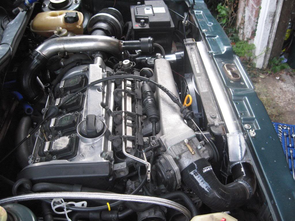

Here is what it looks like in the car.
