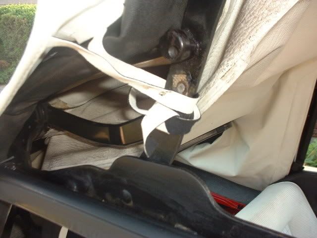

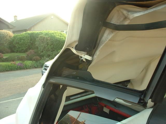

There should be some loops that attach the outer skin, inner liner and the frame together. I guess they are either broken, not connected up or just not present on the aftermarket roof?

I should also show the rear loops that hold the cover down at the back…..in fact, how the whole cover fits…..
In the meantime….try pushing the hood fold IN as the roof goes back…then try fitting the cover…

http://i34.photobucket.com/albums/d109/cabriaulait/roofloop001.jpg
http://i34.photobucket.com/albums/d109/cabriaulait/roofloop002.jpg
hope this helps, the tonneau should fit after
