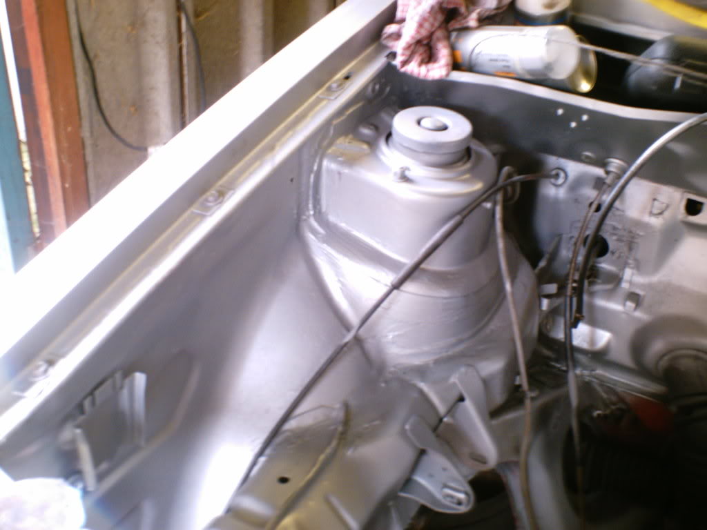

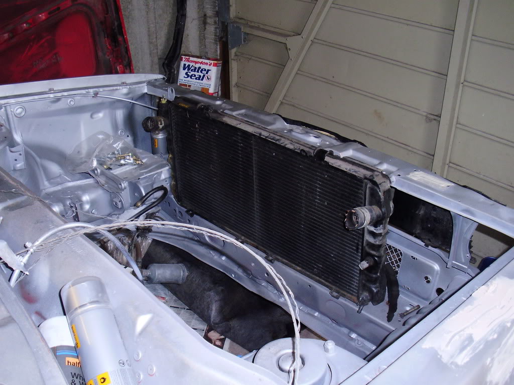

Here is how it came out before I removed everything else, nothing wrong with cans for the bay!
Note above how steering covers/rack etc may need removing, I also had to remove everything like the servo/cyl (note the rubber bits are still on in pic, these are a PITA to fully get off!). Looks nicer than the Mars Red it was in IMHO.

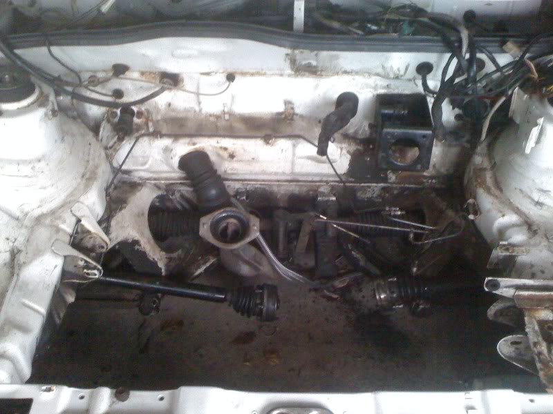

This is how my engine bay looks at the minute. Almost ready for a rub down, repair and respray

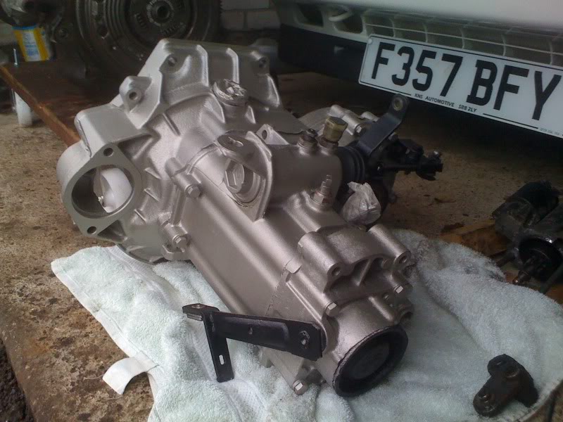

Only got the gearbox done upto now
