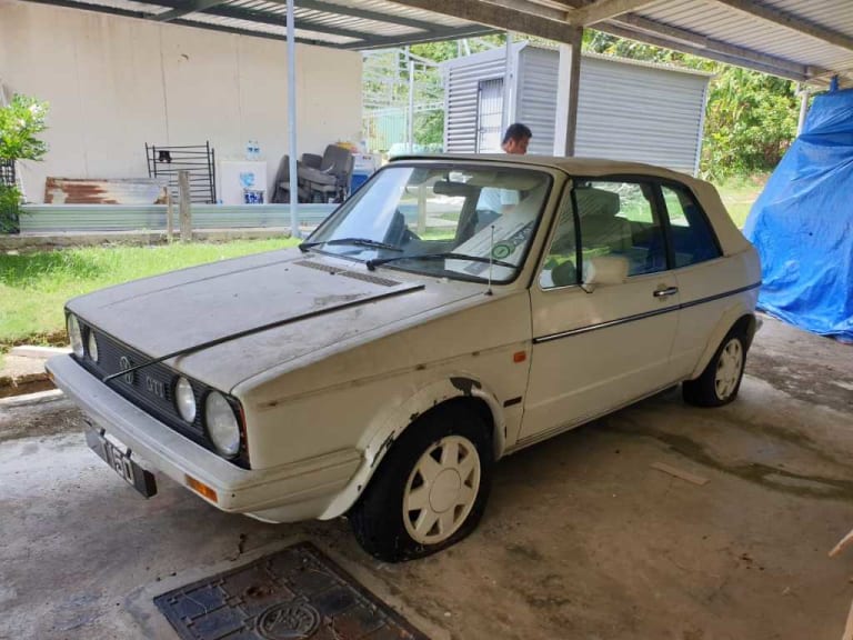

Can anyone advice me what model and year of this GTi
All above still applies…..G –> 1986paul_c said

Car looks like a 1986 too. It has 'small' (for a cabby) bumpers, not the clipper kit. Interestingly, the grille is the later type, maybe in 1986 they used this alongside small bumpers, or maybe its a later alteration.
