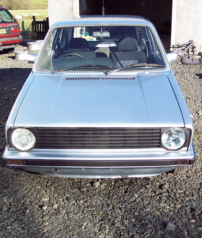

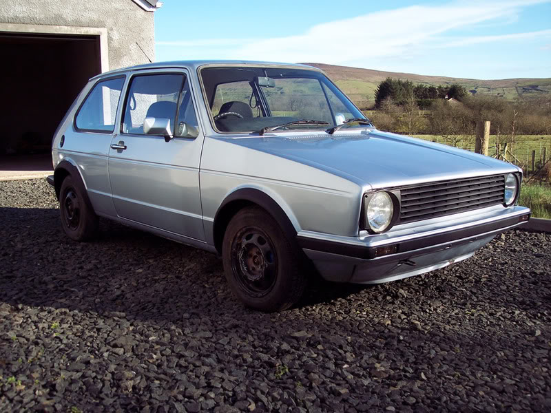

It's a 1600 carb engine with a full respray in porsche polar silver. the owner also says theres not a single bit of rust on the exterior or the underside. its had a few other bits and bobs done to it such as new suspension/ headlights and theres a full set of new seals around the windows. the guy bought it with the spray done so it didnt come with the original badges. are replacement badges easily found? i prefer the look fo the car with them on. i reckon i can get the whole lot for ?900

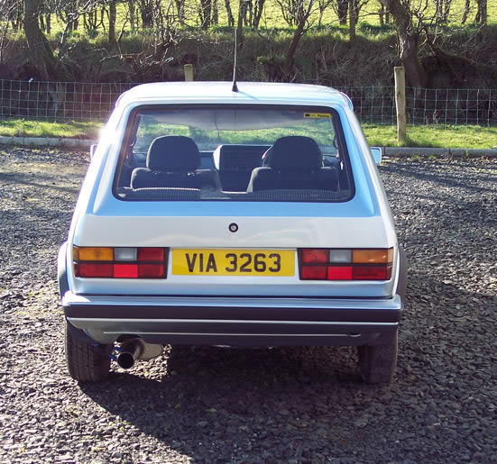

no front spoiler buts that easy to put right.
the rear bumper has dropped. this could be as simply as it needing putting straight but it might also be a sign of a bump.
looks like mk2 seats in it too.
and it shouldn't have the wheel archs either.
if you don't want a stock car and if it's as he says with no rust then could be good purchase.

has he got a massive stack of recipets, mots photos of respray etc?? if vehicle has just been reprayed WHY? (hence droopy bumper and *shudder* painted bumpers)
MK2 grille looks ridiculous on it too. what spec should it be? a driver??

be careful with it and give it a good going over is what people are trying to say here.
Probably the single most expensive thing to put right properly on the car, I'd wager.
A good way to check how good the bodywork has been done would be to pop a door card off and look to see if the trim holes are welded up (= good) or just filled (= bad).
If you get any bad feeling at all don't buy.
