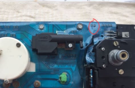

So I bought a new screen and contacts from Alisdair who sells them, but in the process of changing and testing that the instrument cluster shorted against the metal part or the dash and with a puff on smoke it blew the voltage reg, and two other 'pins' (shown in picture pre blow).
So we managed to replace the voltage reg, some other wires and the blown fuel relay so everything now works except the oil light. And we think its related to the pins circled but can't findany wiring diagrams to see how tgat oil light works (other than the obvious)..
And just to make it even more fun, the mfa screen still doesn't work!…
