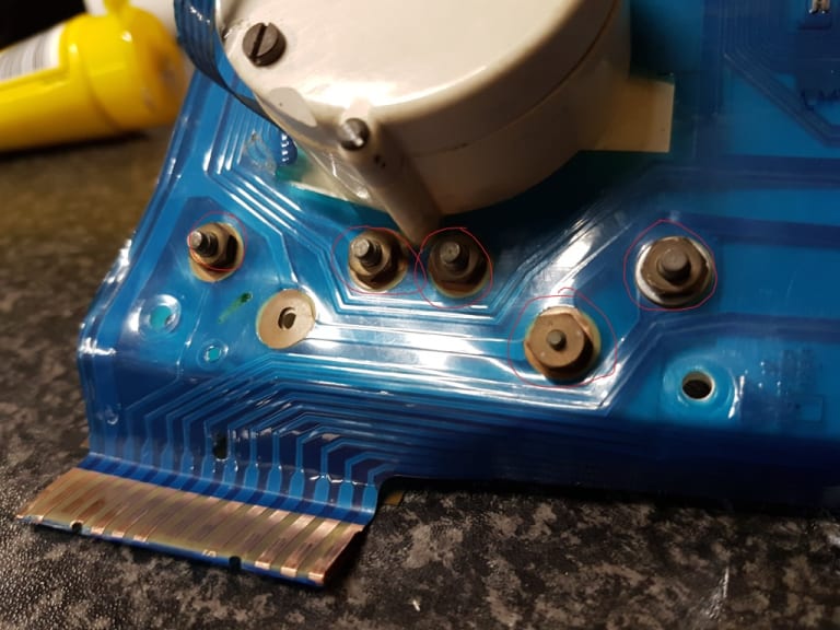

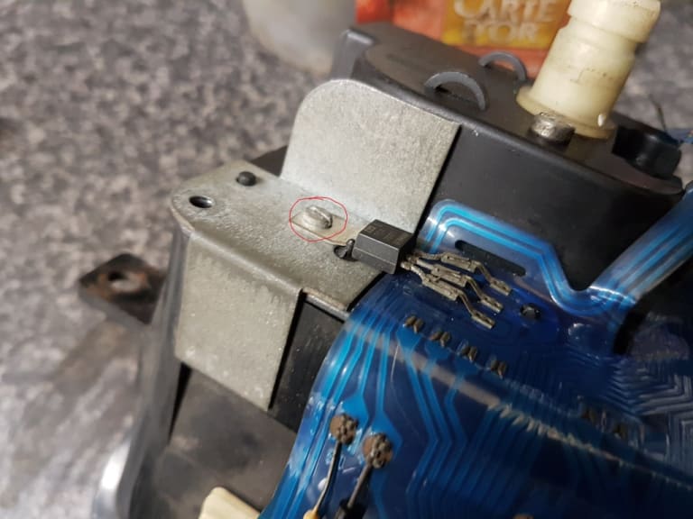

now this screw and the metal bracket under it along with the two screws on the back of the speedo drive

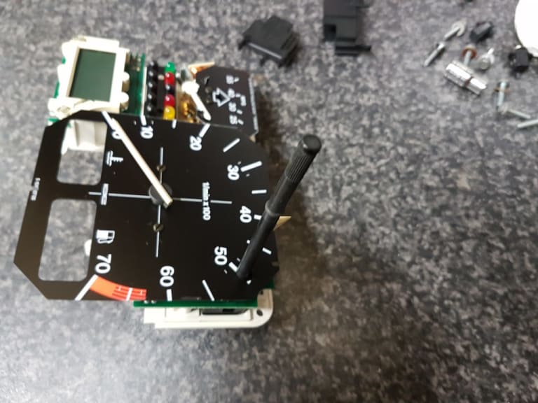

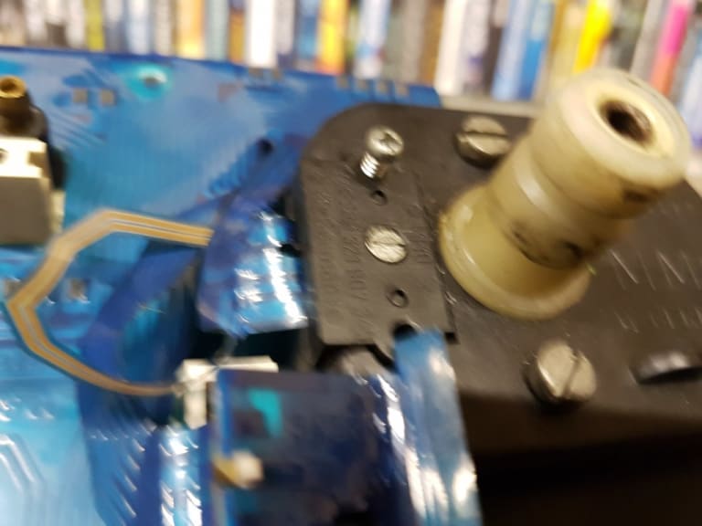

Remove these nuts and little wshers from the back of the rev counter bit. Now the front of the speedo should now be free but be careful with the printed circuit board

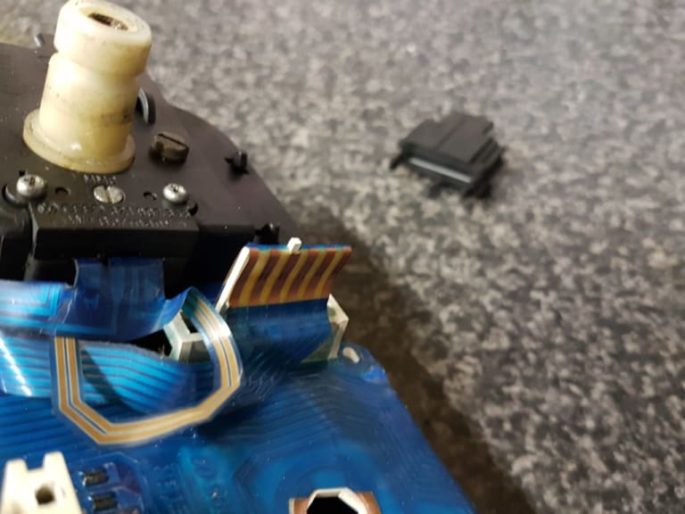

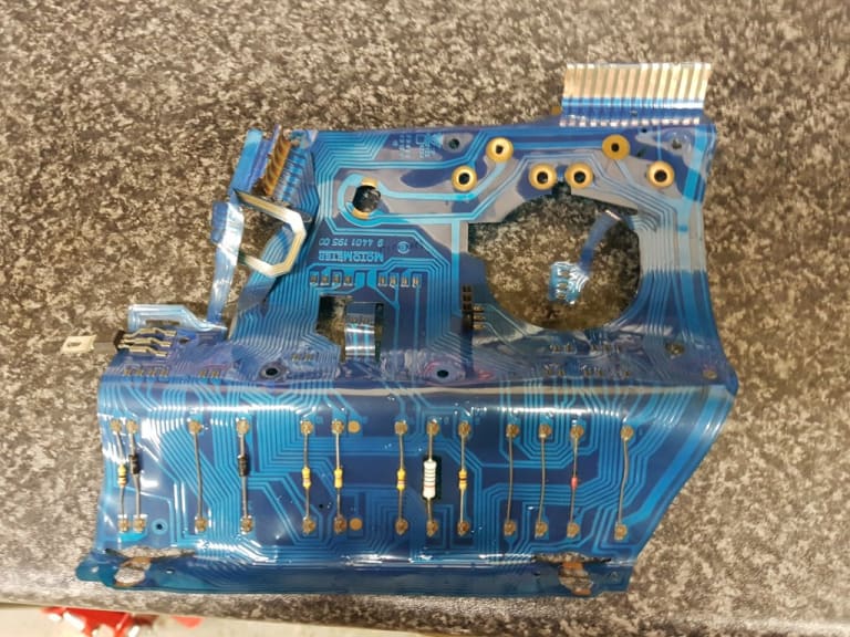

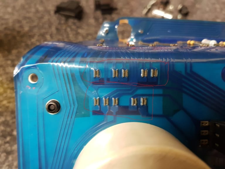

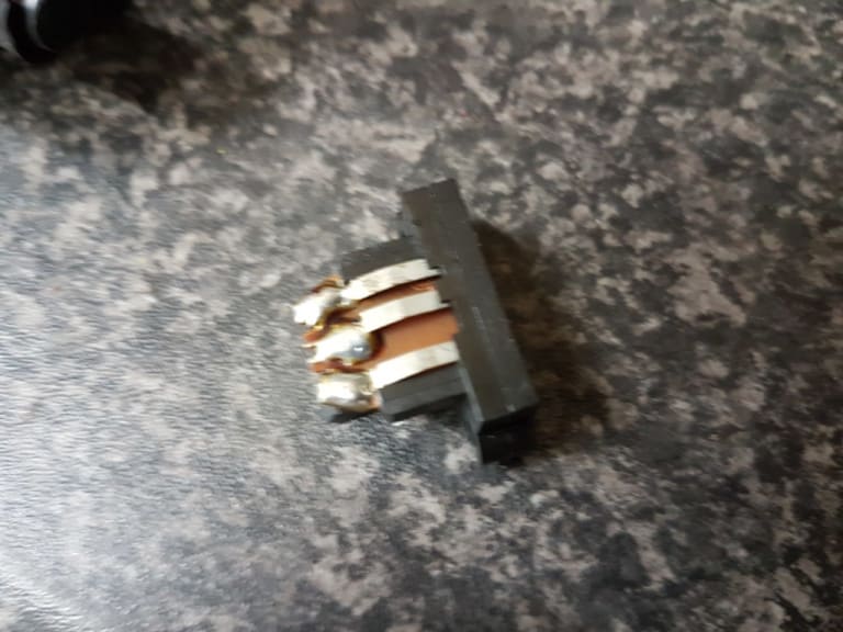

now you can remove the printed circuit but be careful with it, there are several black connectors under it that need to be removed carefully. Its seems hard work but it's quite simple to do just take your time.

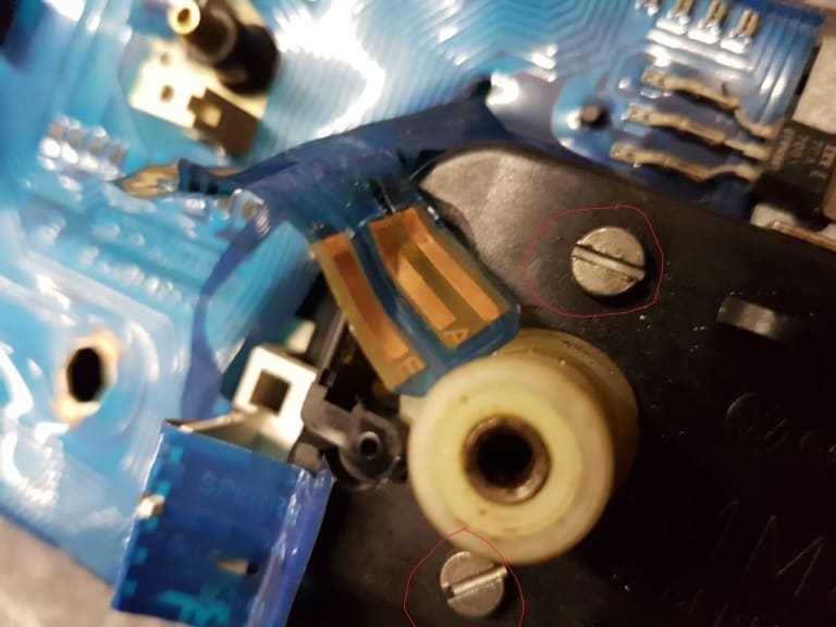

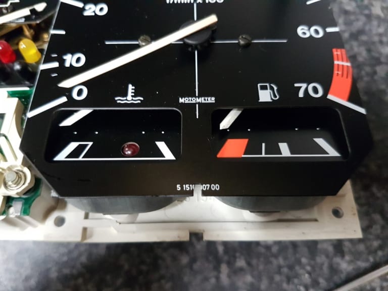

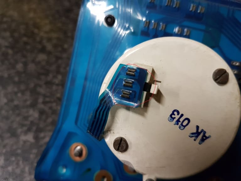

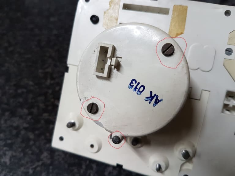

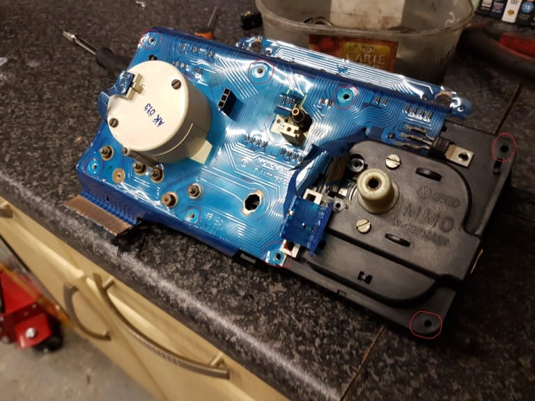

remove 3 screws from the back of the rev counter and remove it. be care as you are also removing the fuel gauge and temperature gauge. Don't catch the needles on owt
Then remove the MFA 1 2 selector there is a small white clip at it's base

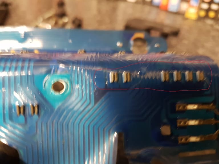

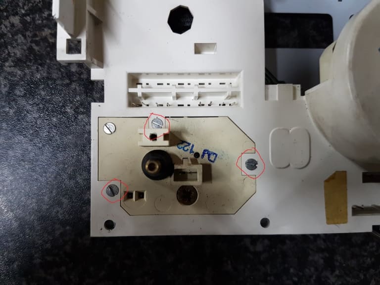

Now remove these 3 screws at the back of the economy meter then there is about 3 screws holding the circuit board to the remains on the cluster

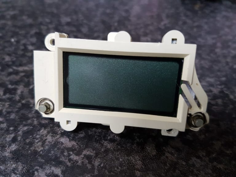

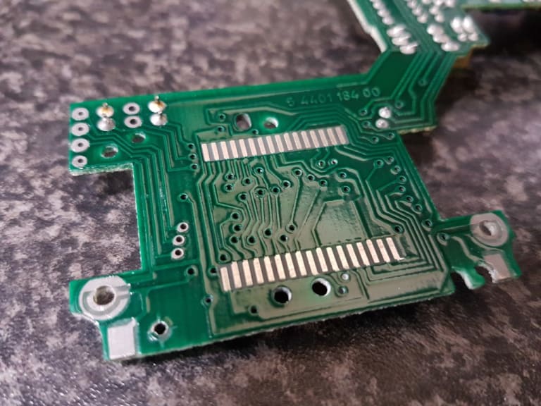

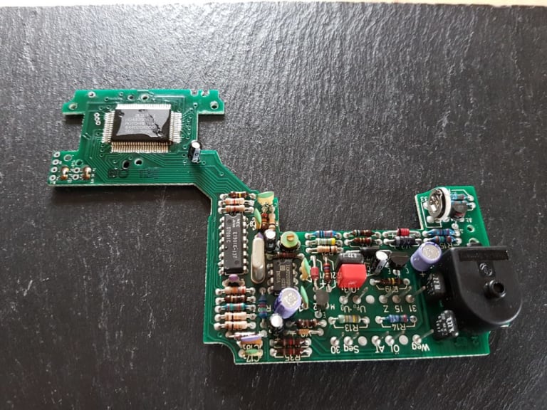

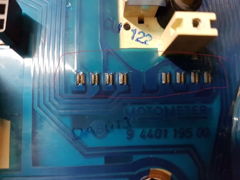

remove these two screws to liberate the LCD. My circuit board was not very clean and the contacts very dull so used brasso on the contacts.

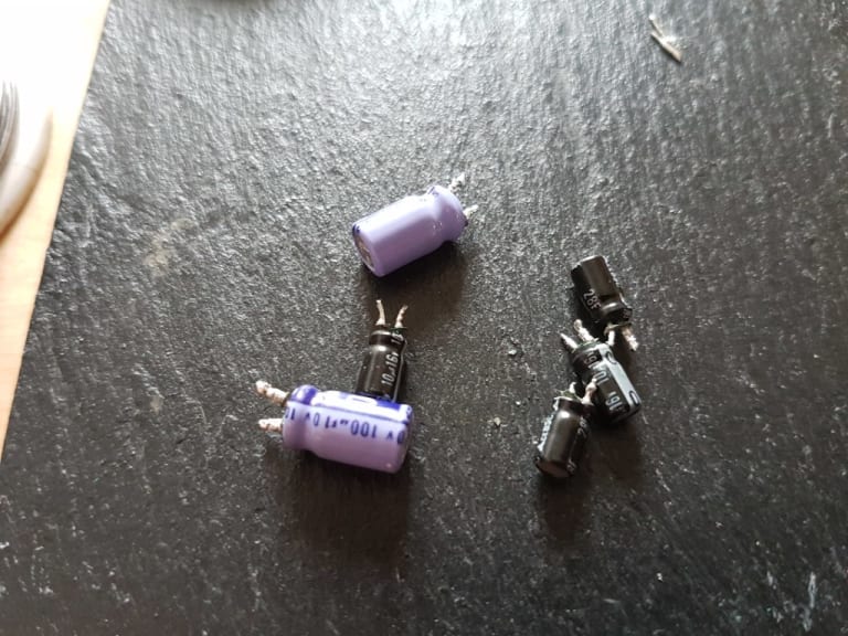

Now the main issue with my board was the capacitors were all weeping onto the circuit board. Removed them and cleaned the board before soldering new ones in place.
Now you can actually use ones with higher voltage rating as this wont hurt it really. For example 12v replace with a 16v.
What must be the same is the µF rating
there are 6 in total 4 small 10uf 16v and 2 large 100uf 10v
Put back together in then in my car and everything works even the mpg gauge when in 5th
