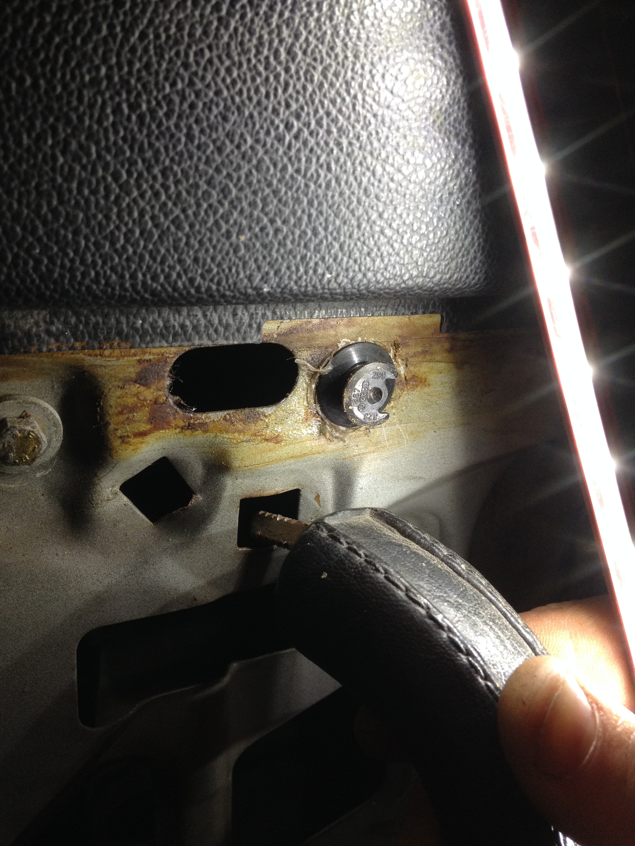

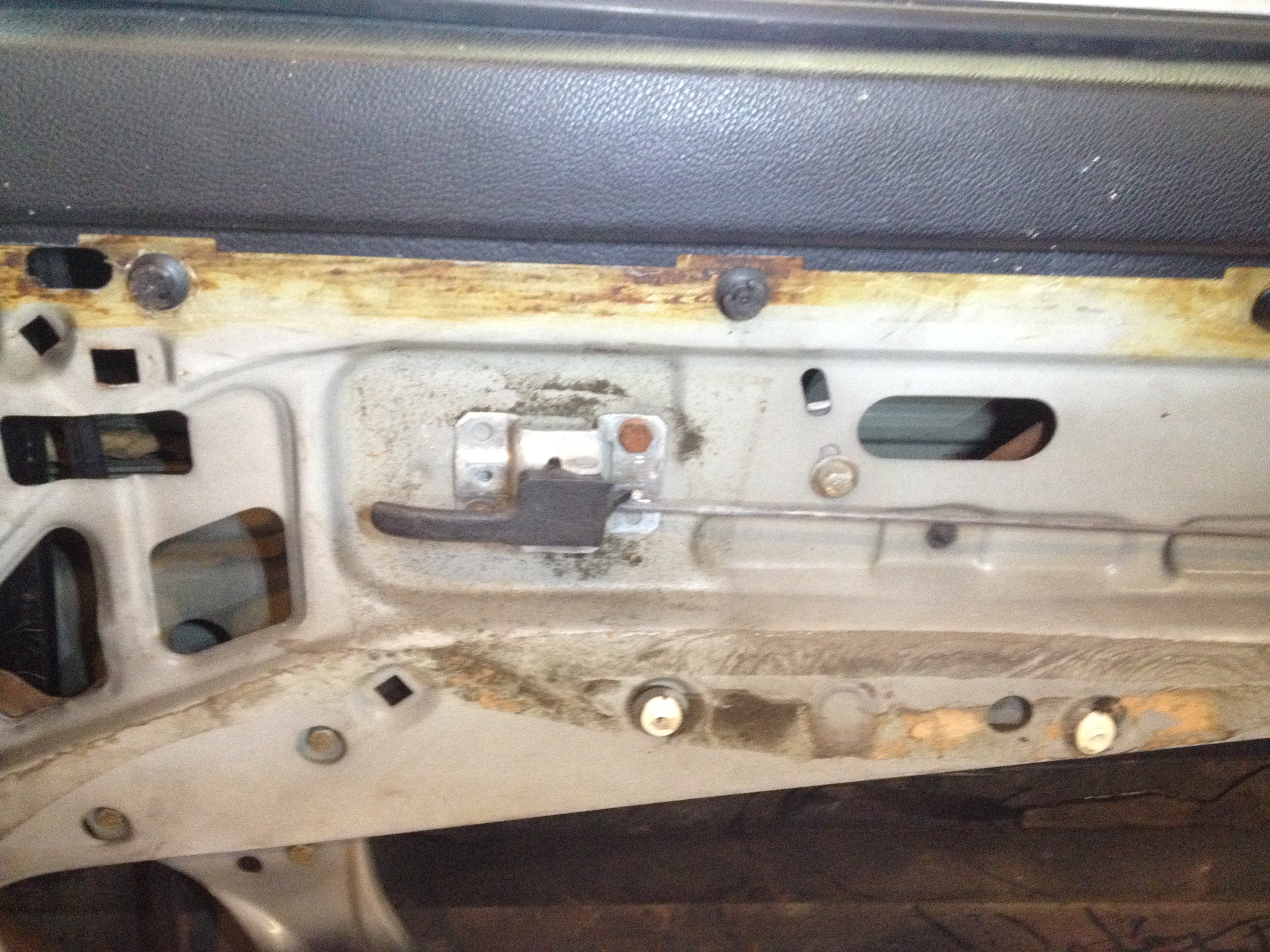

first off I removed the door panel 1780 views (3 Mb)

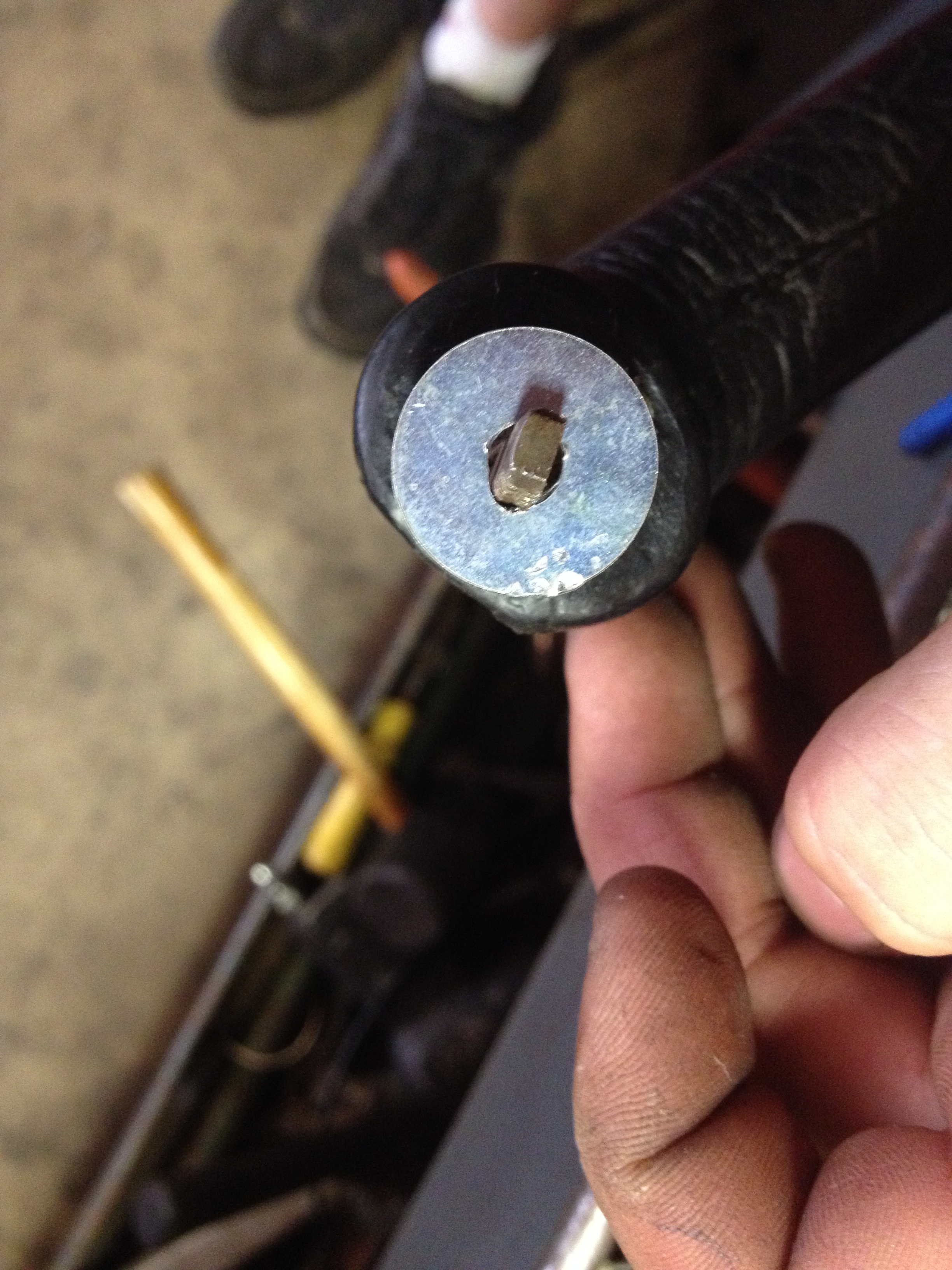

I then found a washer to use that would act as my original clip, which is a 5mmx20mm washer 2109 views (1.35 Mb)

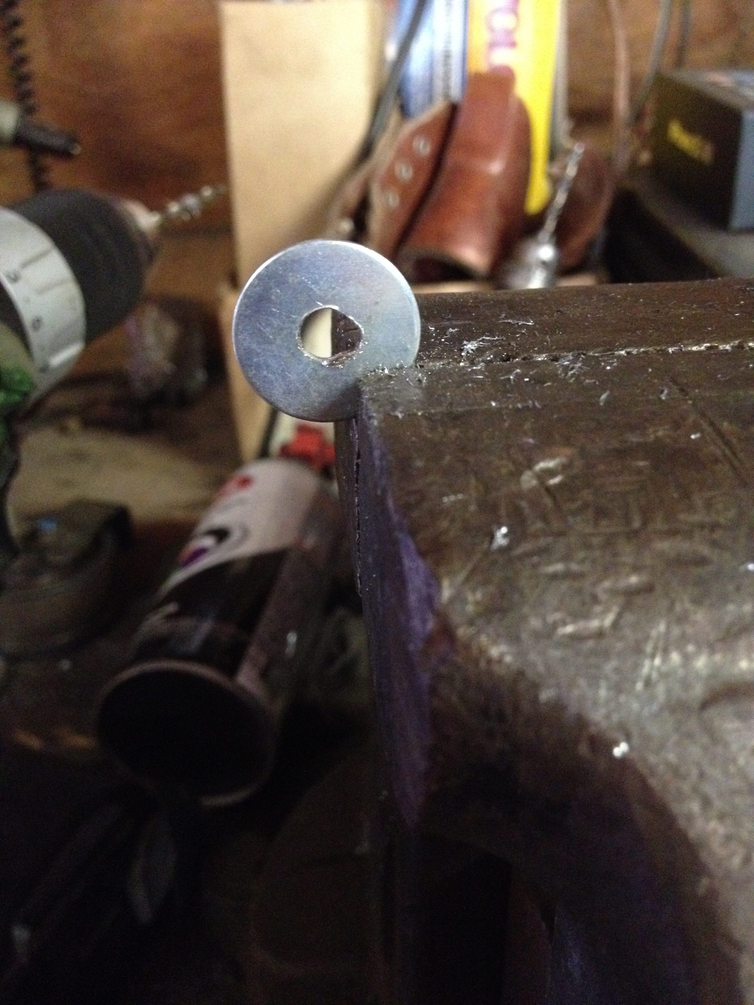

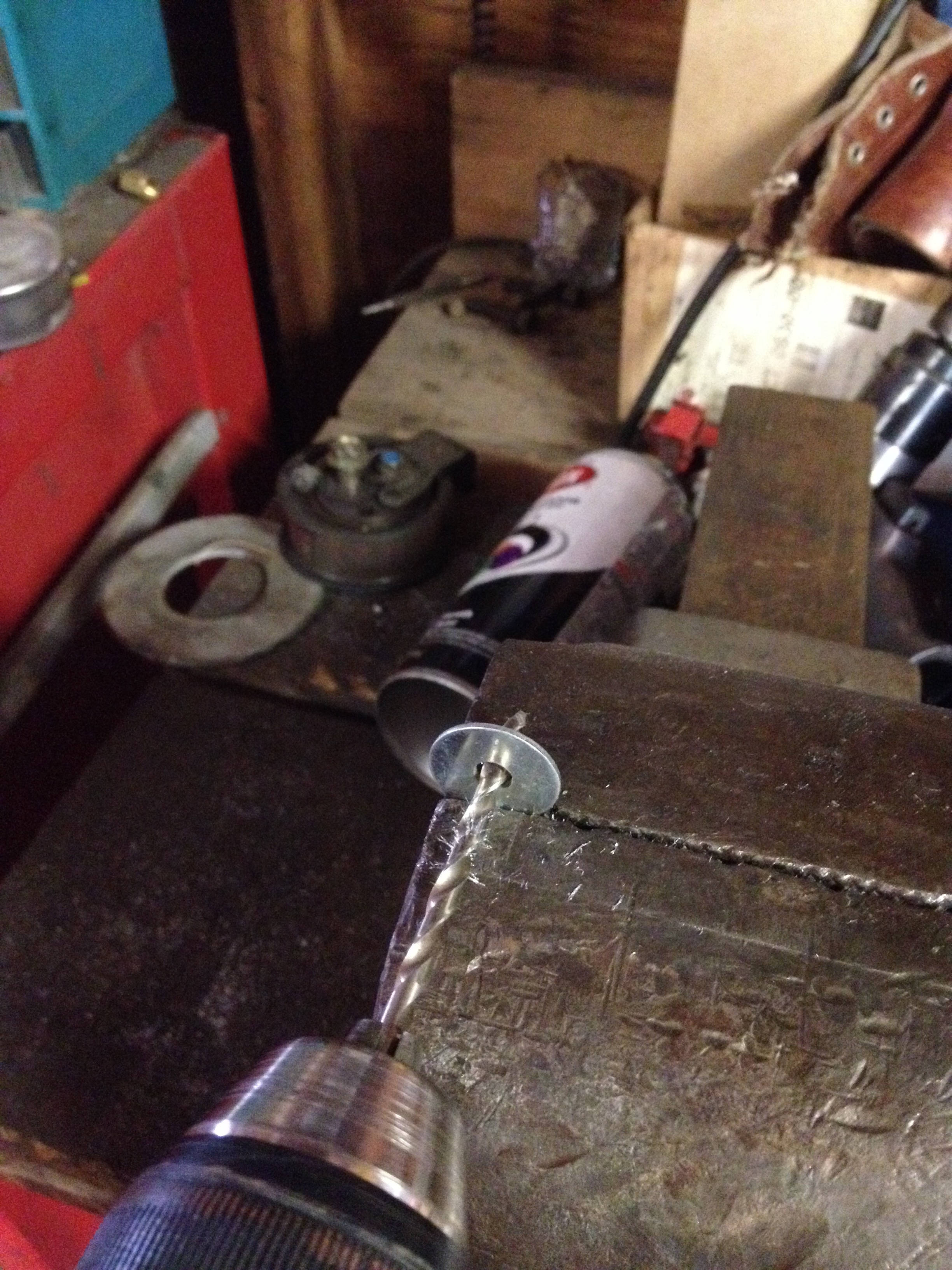

I then drilled a notch in the washer so that the door handle fit and would lock when rotated  1403 views (3 Mb)

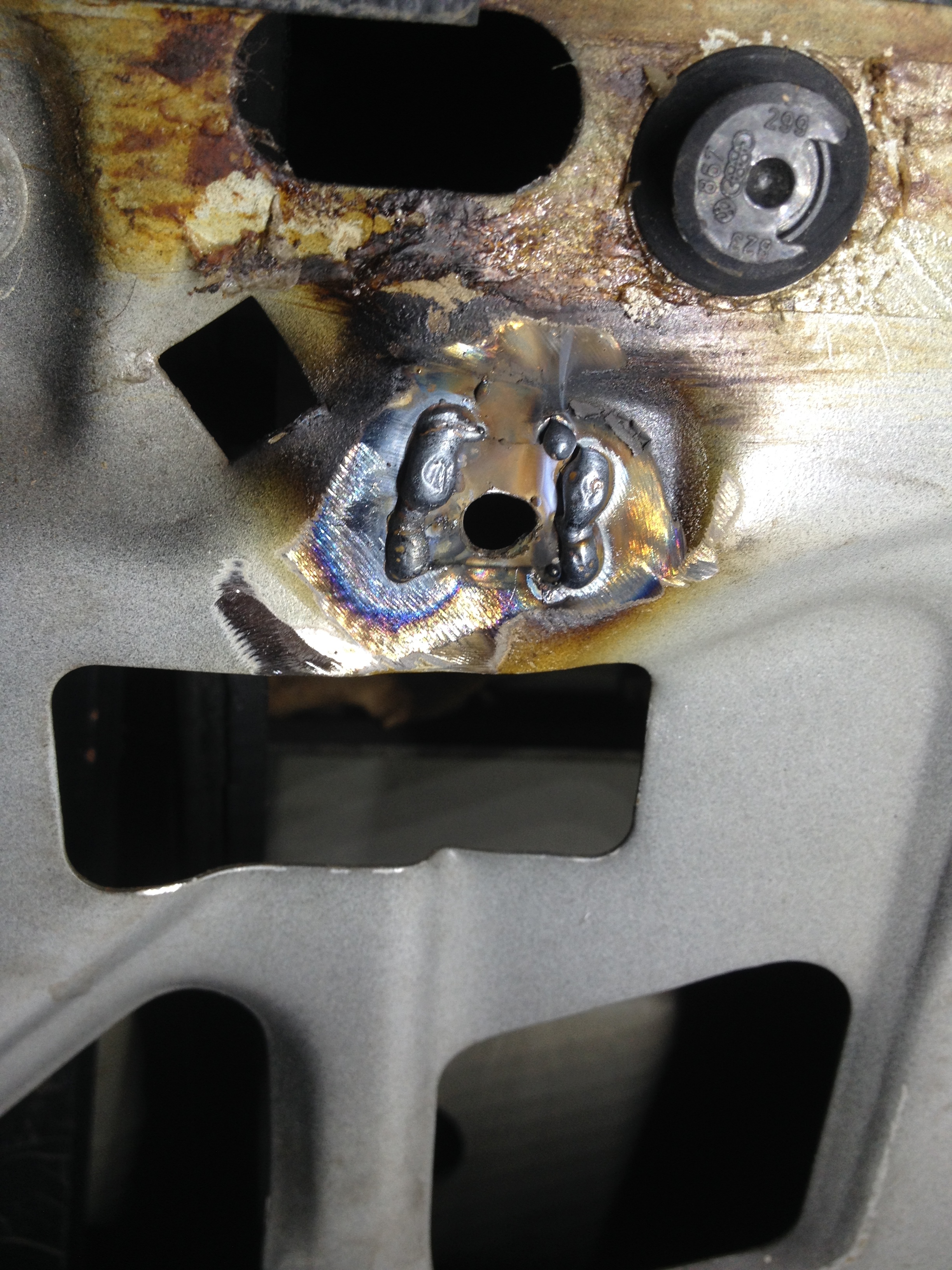

I then tack welded my washer in place, used a grinder on it, and painted it (i suck at welding), not my armrest is as good as new and stronger! 2385 views (3 Mb)
