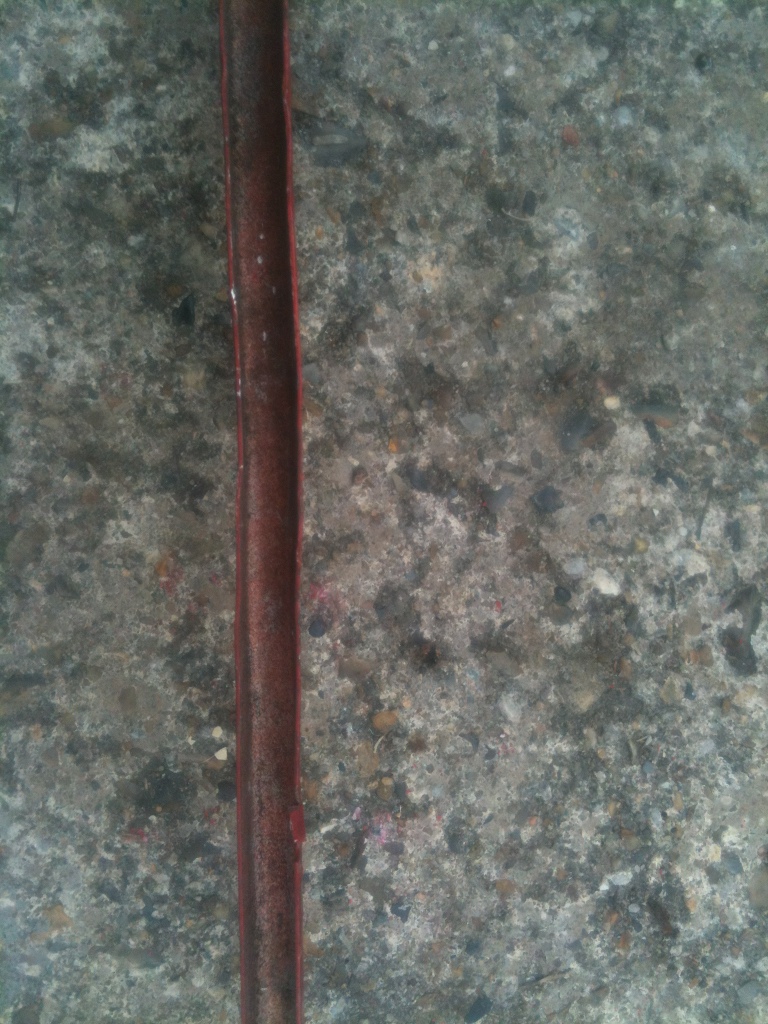

Now you have your trim out in one piece, place it face down on your work surface

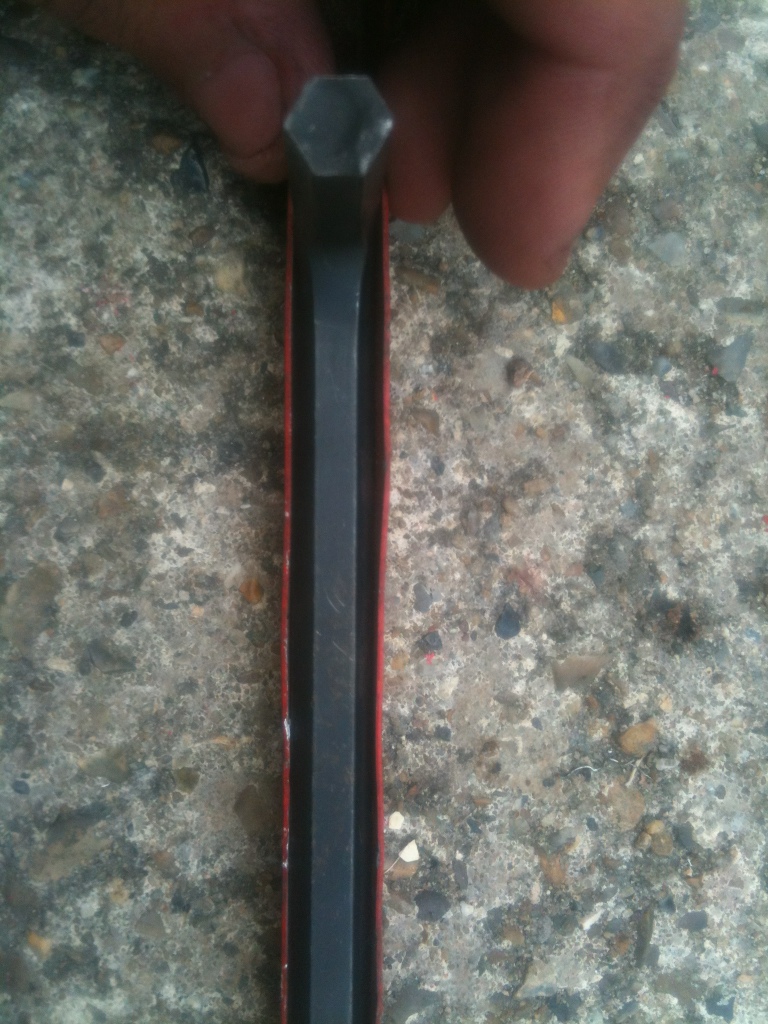

You can't really see in this picture but the trim piece has kinked out aswell as bent a bit. Time to bust out the allen key.

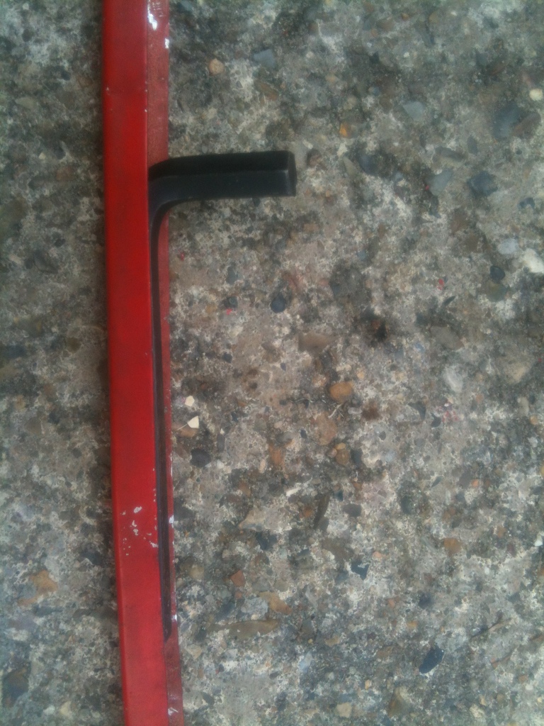

Place it just behind the damaged area ( make sure the perpendicular piece of the allen key is poiting directly upwards!)and gently hammer it in, if the area behind is straight, the allen key should just push in.
Using your hammer, hit your allen key on the perpendicular section (that's the sticky out bit) until it has gone all the way through the damaged area.
Now, flip the trim piece onto it's side and again using your hammer, gently tap the trim where the allen key is placed, once that side is flat, flip the piece over and repeat
Remove the allen key and voila, not perfectly straight but once fitted to the grill it will be fine. Shouldn't take you more than a minute or two!
