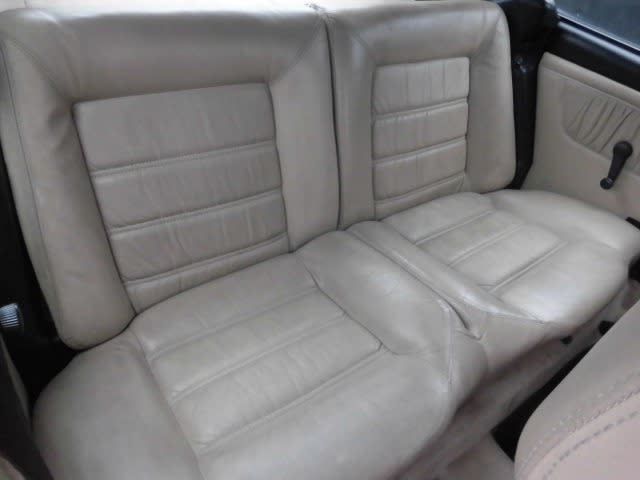

Since my 93MY Cabrio (E-152HK) dose have front speakers only, I would like to install rear ones as well.
Do you have the Grilles but no speakers? or are the Grilles missing totally as that makes a totally different installation.

Currently my girl is away from home, she is awaiting for Japanese MOT at the garage. Thence I have put a picture as image. As you could see, there is no speaker grilles at all. Based upon your instruction, I do have to purchase the speaker grilles as well as extension parts, but of course 4x6 speakers. :-)
Massive Thanks from Japan.
