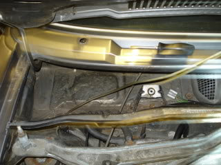

step 1. Remove the scuttle (water drip tray) to allow acces to the area.
(doesn't really need a photo)

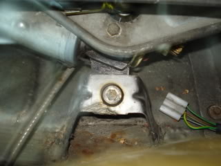

step 2. Remove the link bar between the engine bay and bulk head. (10mm bolts x2) I used 1/4" drive ratchet and socket.

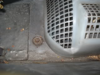

Step 5. Remove the heatermotor grill(4x 8mm hex head screws) I used 1/4" ratchet and socket. Then pass out of the scuttle to the left justlike the wiper motor. (May be a bit of a squeeze, but it does come out.)

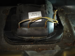

now we hould only be left with the heater motor itself.

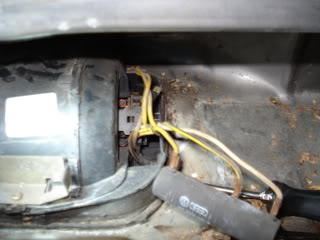

Step 5. At the front of the heater motor is the variable resistor for the motor, this should just come out of its brass looking bracket. Use a flatblade screwdriver to easily open it up from one end and remove. It is ceramic so be gentle rather than brute force.
Now remove the other wires from the motor itself. (2 spade terminals), and place the wires and resistor to the side like so.

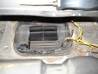

Now there should be nothing in the way like so.
