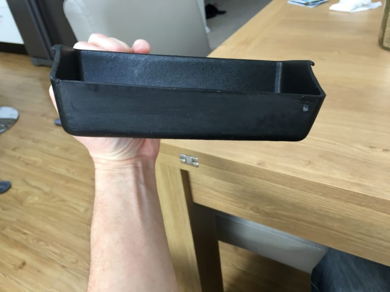

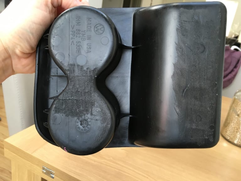

Get your Dremel out, and remove the thin webbing from underneath the cup holder, then remove the clip at the back.
Next you have to remove the top section of the back edge, leaving approx 1" of depth, and taper an angle in to the sides.
Go and test fit it , and trim until it's a nice tight fit in the centre cubby.

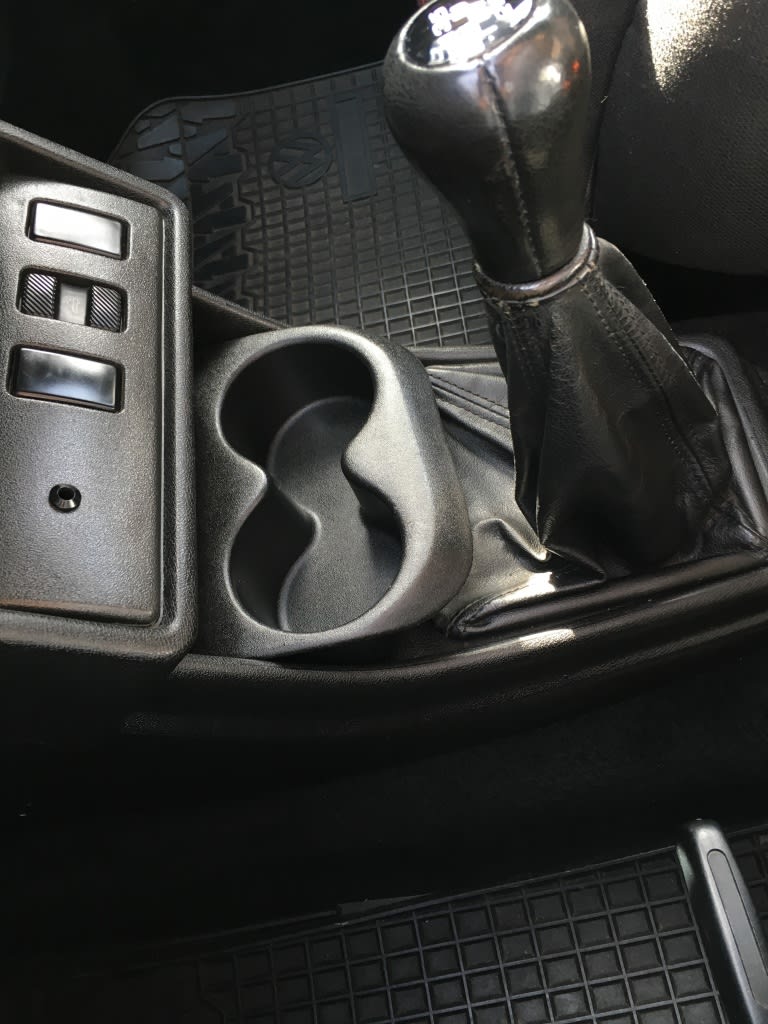

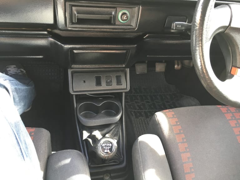

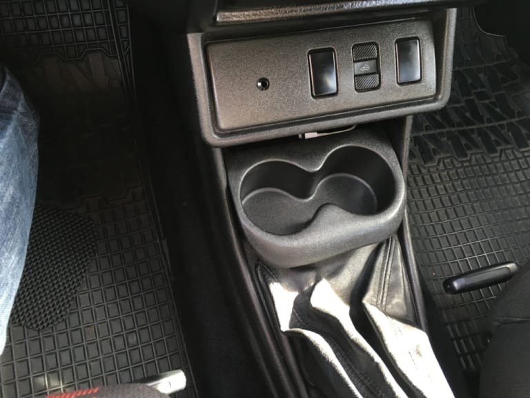

Clean the cubby with acetone to remove dirt, and stick the cup holder in place.
