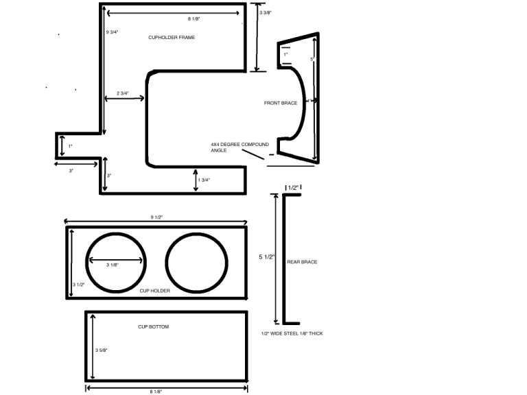

This will allow the seat to fully slide front to back, the only thing I noticed is that when you have the seat full front, that when you fold the seat the adjuster moves the thing to the left as there is a wee bit of clearance not great but could be remedied by increasing the height of the curve at the back about 1/2 or 1/4 of an inch.

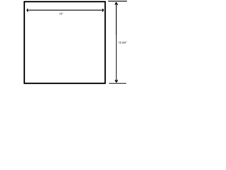

Here is the plan that is basic, your carpet and pad may vary but on my 93 this is what I have made.
It is out of spare 1/4 Sanded plywood that I had laying about.
The Cup holder and cup holder bottom was made out of scrap 1X4 that I had laying about.
Yes the width of the Cupholder to the Cupholder bottom is 1/8 difference, to allow the side frames to spread out a bit.
I used number 8 X 1" wood screws
Pilot drilled all holes with 1/16 bit. Plywood Especially
Center Drilled the Front brace with a 1/8 hole, I used a 16 penny nail to Pierce the Transmission Tunnel so I could screw a 3" construction screw at the front center brace.  I used a single screw for the front brace to Frame.
The Front Brace is to steady it I double that it is really needed, but hey.  The front brace has a compound cut that is about 3.5-4 degrees front edge to back and then bottom to top to accommodate the spread of the frame at the feet.
The Rear Bracket was a Piece of 1/8 thick 1/2" steel that I had laying about.  It is Bent at 90 on the ends.  This Catches the Feet of the holder to keep it from rocking forward on a stop.
The rear Bracket is attached to the REAR of the parking brake frame.
If you look there is a hole centered in the rear.  I used a speed nut, and 10mm short 1" or less with washer and a 90 degree angle bracket I had laying about.
Sand every corner round, I sanded with 220 grit paper.
Originally I Stained and then 3 coats of Varnish I loved the look but it didn't work in the cabby.  So I used Duplicolor Gloss Black Vinyl Paint 3 coats it matches the dash.
With that said here it is.
Original was too tall and a tad unstable so I whittled it down a wee bit.
Remember I used Basically a Jig-Saw to do Most cuts, But I did use a Compound Miter to make the Front Brace.  I may clean it up with a router later to make it look pretty, but it is under the closed handle of the e-brake.

Nice work. How is this fixed?  Is it wedged in place?
Wes
No it sits on the Plastic inner Rail covers, I hold it in place by using a speed nut, on the rear of the e-brake handle with a m6X45mm Allen headed screw and a small angle bracket.  I did place a screw in the front under the e-brake, but I actually don't think I need it.
If you feel behind the e-brake cover, there is a flat spot about 1/2 inch wide, then you feel a "Hump".  I have the metal 1/8 inch thick and bent at 90 for a half inch to tie the rear of the thing so it cant tip over, and it keeps the bottom feat firmly in the seat rails…
Added the template for the wood.
