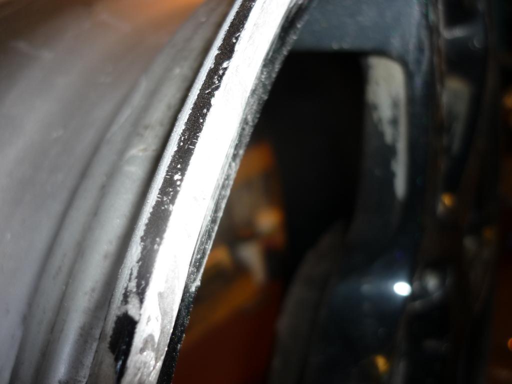

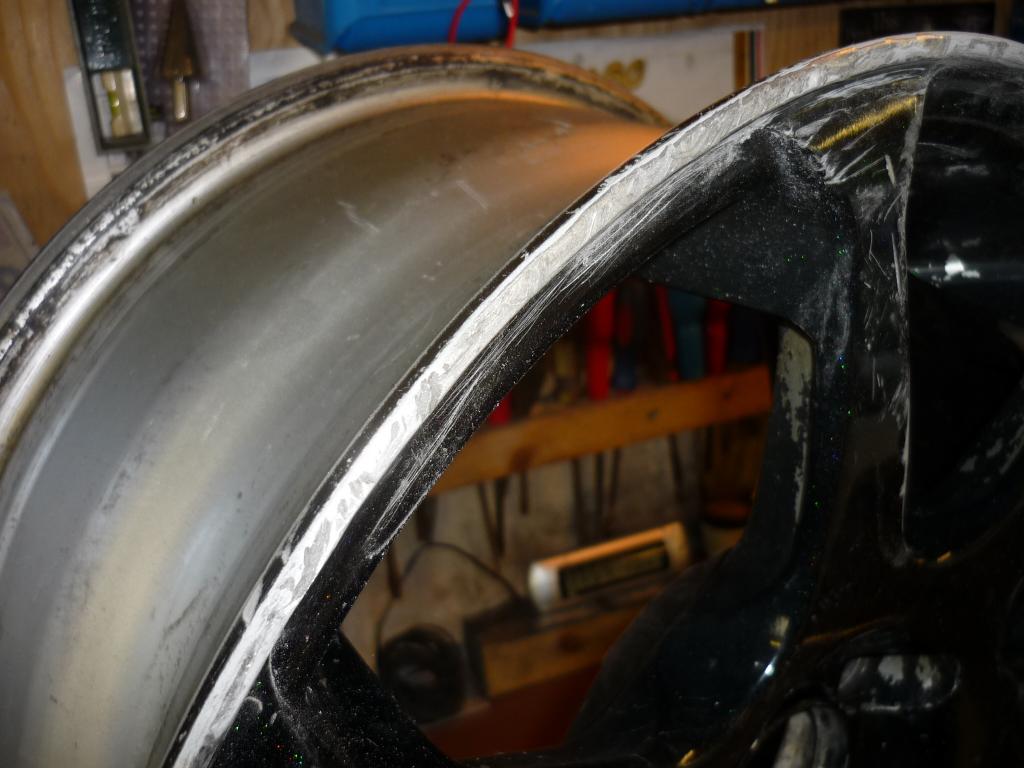

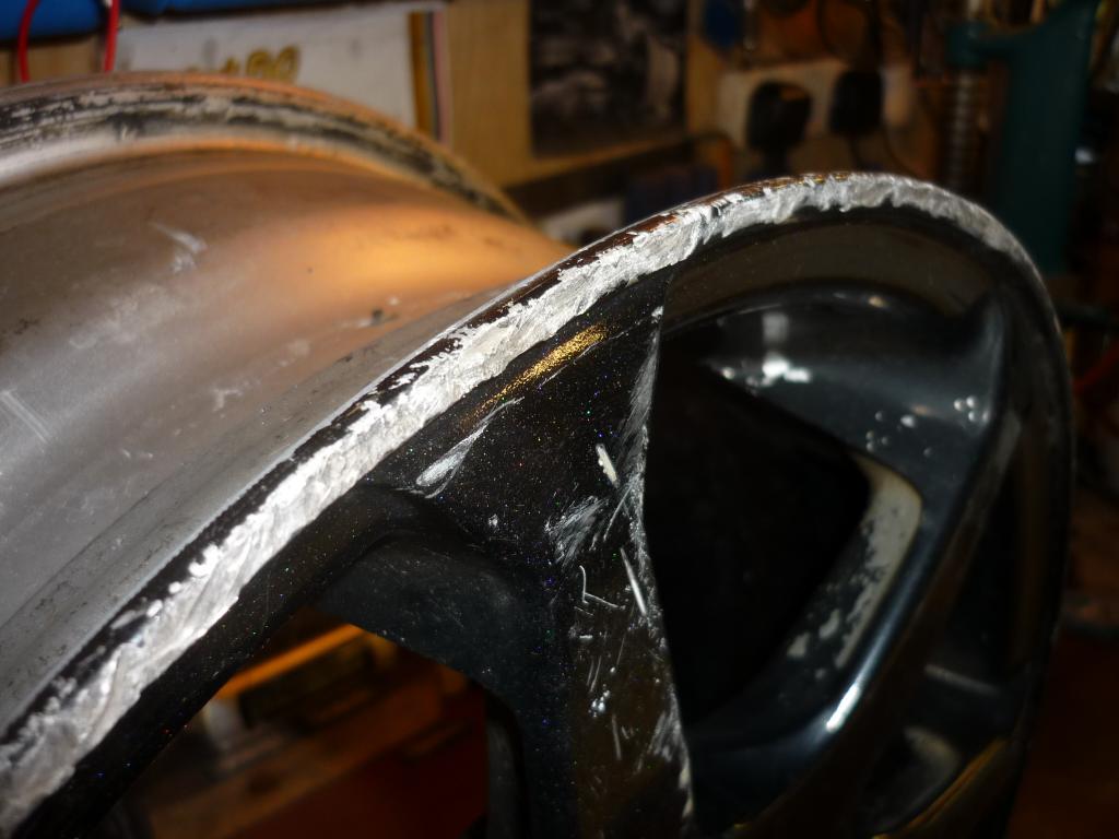

2, Now they're clean you can see what you're dealing with. As you can see with these it appears they were driven along more kerbs that not!
Using a needle file or similar small fine file, clean off the edges of the dings where there are sharp sections of alloy sticking outside the original edge of the wheel. This needs to be done on the outside and inside of all of the kerb marks.
Then run the file along the top of the kerb rash to remove any sharp areas and generally dress the area. Don't go mad as you'll be adding a bit of filler to bring the levels back up.

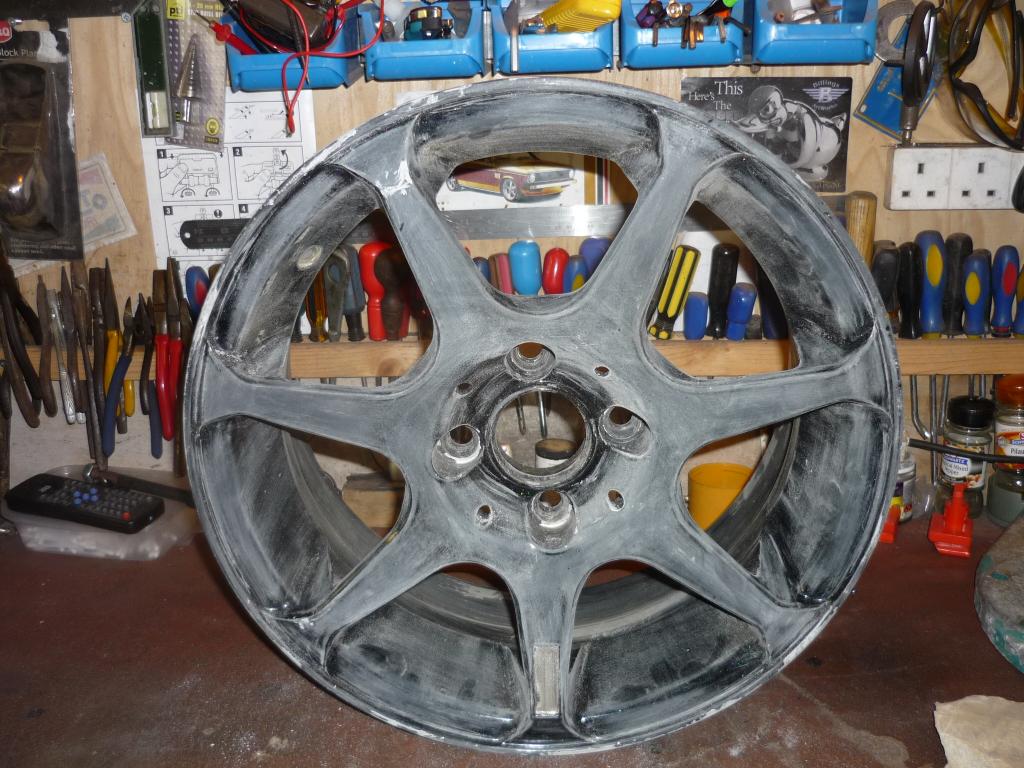

3, Now add a small amount of filler to the marks. I used scratch filler as by now the majority of the deep scratches should have been filed out. Then sand it all down to get a smooth finish.
4, Now the next stage is to rub down the entire surface of the wheel that is to be painted. In this case I'm doing it all including the inside of the barrel. Use a fairly abrasive sandpaper for this bit. I used 80 grit. I should add at this point that as these wheels were still covered in the original factory powdercoat that I have sanded them down. Usually to remove the powder coat I would grit blast them as this leaves a much better clean surface from which to start. However in this case the paint I'm using will allow the sanding. I've tried paint strippers on powder coat with little success so my advice would be to either paint over it or grit blast it all off. If the wheels have only been painted then you can use some Nitromors to strip the paint instead which will enable a much better finish.

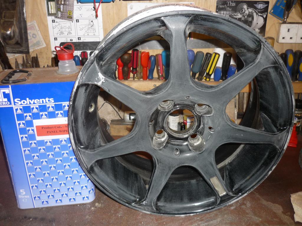

5, Give them a blow off with an air gun or wipe off as much dust with a rag, then use some panel wipe to clean the surface of oils, grease and dust. At this point you might want to wear some gloves if you haven't been so far to stop the grease from your hands getting on to the surface.

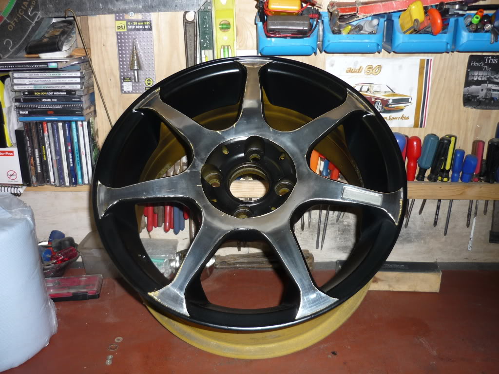

I had tried something different on one of the wheels earlier and polished up the spokes to give this finish
Same initial process but with a lot of polishing later!

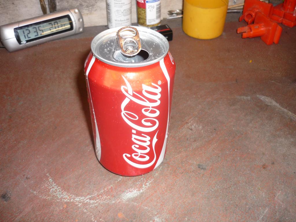

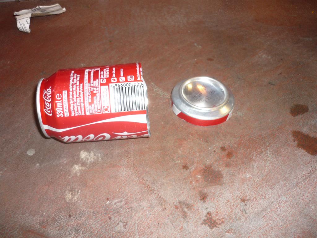

So then these wheels didn't come with centre caps. As I'm cheap I thought I'd make my own. A strange thing I noticed some time ago is that the outside of the centre of the wheels for VW's is that it's the same as the inside diameter of a coke can………..
1, Buy a coke can (you get a free drink in it too!)

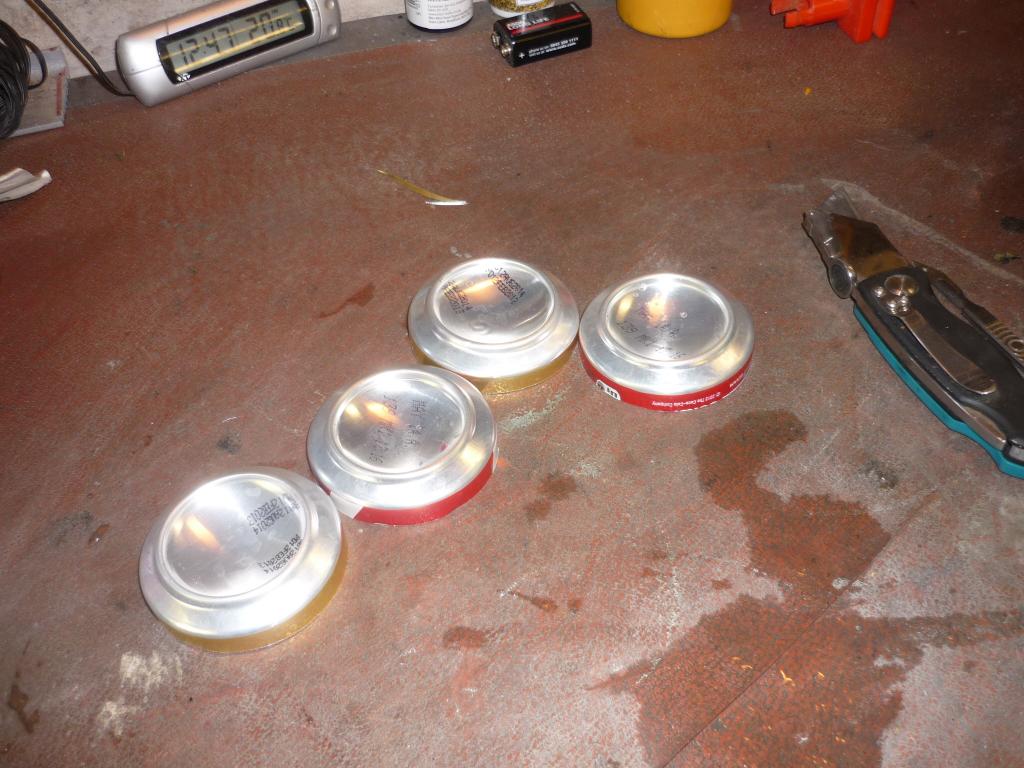

2, Chop bottom off said coke can. Use a Stanley knife, be careful with this bit as it's easy to slip and chop some skin off your thumb
3, Cut to size with some sharp scissors and tidy up the edge with some sand paper and then cut 3 more.

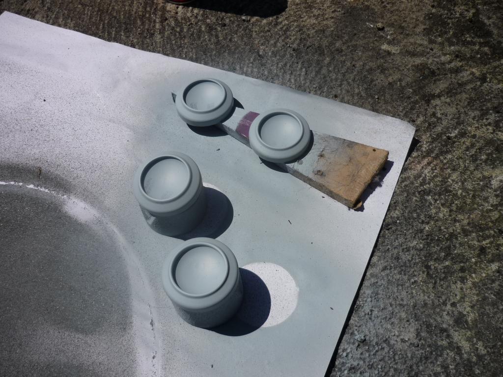

4, Give them a sand down and add some etch primer
5, Add the colour of your wheels or contrasting colour if prefer
And there you go. A set of wheels to be proud of and cheap too. The strange thing is that although everyone knows what the bottom of a drinks can looks like no-one will realise that is what your centre caps are made from!
