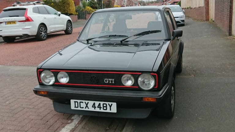

As Briano1234 said they do wipe the full screen and go to the bottom of the windscreen when they are on! It's only an issue when the wipers arw switched off.
Pic when off.
Pic when off.
