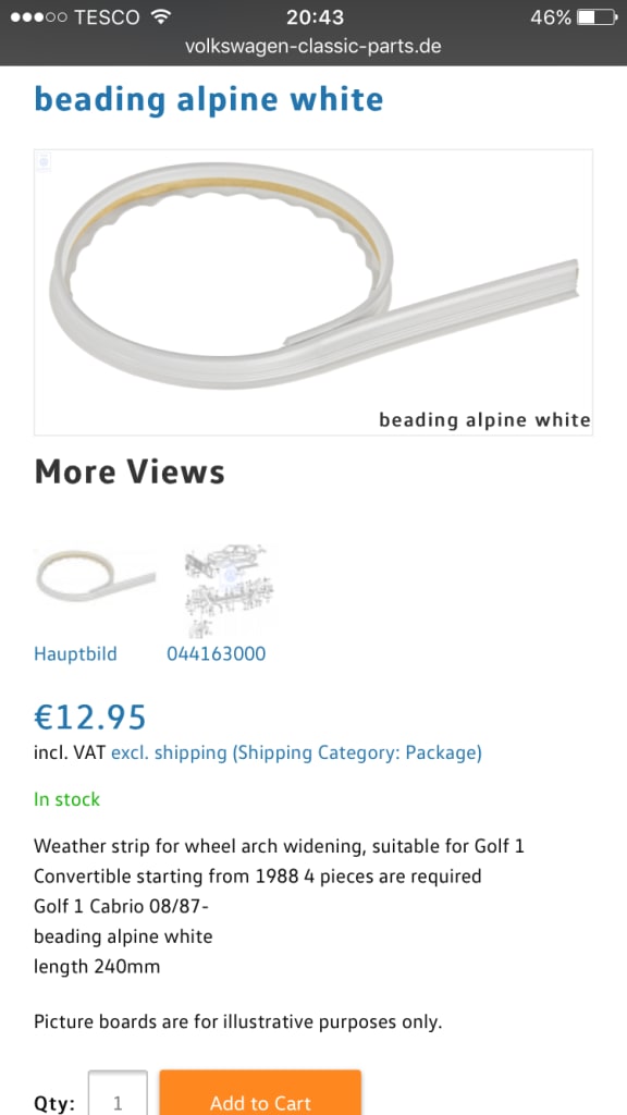

What do you reckon on my last post? The part number matches to what you're saying and tgey say it requires 4 per car even when it says front left? Bit of a weird one!Briano1234 said
They only show one type 155853977 they don't mention left or right.

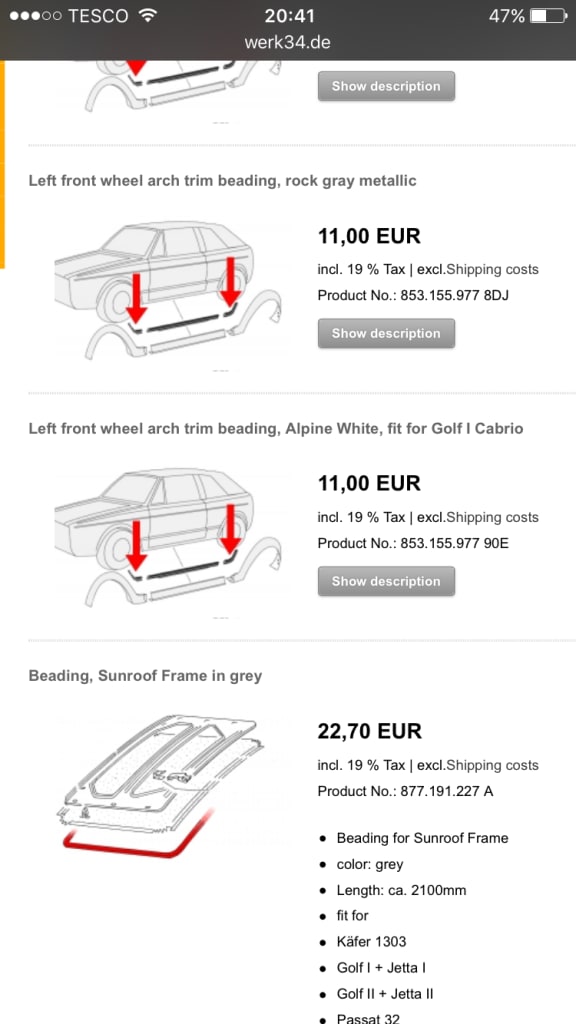

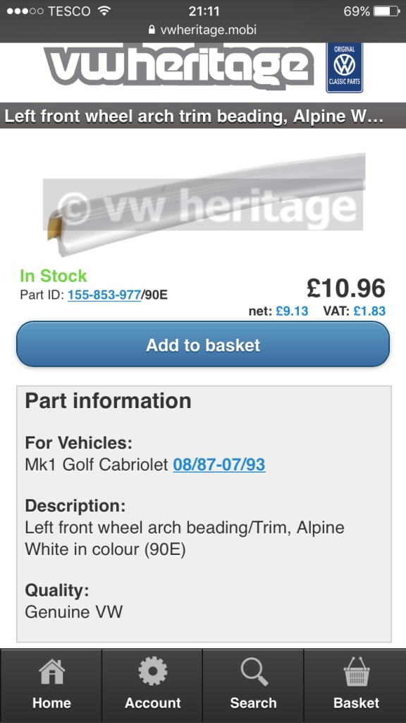

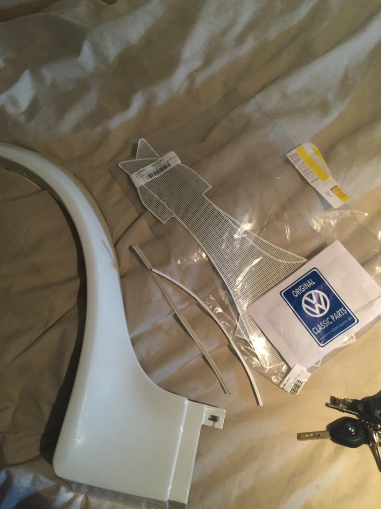

Hi thanks for those pics I only need the rear but they don't stock it in white! So you bought 4 of the rear trim and it fitted all 4 corners? I'm convinced they must be identical but for my colour they just stock "front left" very puzzling!Theo/clipper said

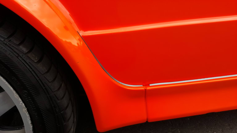

Hi, thought I'd show you the recently fitted beading on front and back arches. Bought from heritage, although they say they don't stock beading for the front so I purchased 4 for the rear to see if they fitted.![]()

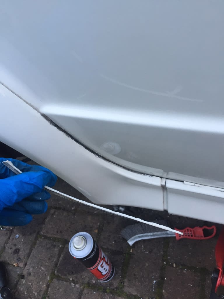

Hi there, could you find me a link for this full set if possible please? I've never been able to find it! What I've found from removing the originals is that the skirt beading is genuinely made to perfectly fit one arch rather than cut from a length, and is a C shape to wrap around the lip of the side skirt, whereas on the arches its more of a flat edge likeLanky512 said

That's what I thought surely they'd be the same, so in my case get "left front arch" for all corners, thanks!Theo/clipper said
Yep, 4 rear wheel trims and fitted them to all corners.

As I'm local to vw heritage I had a trip their this morning to double check they fitted even though they are listed for front left, they do infact fit all 4 as yours did! Glad to have it sorted nowTheo/clipper said

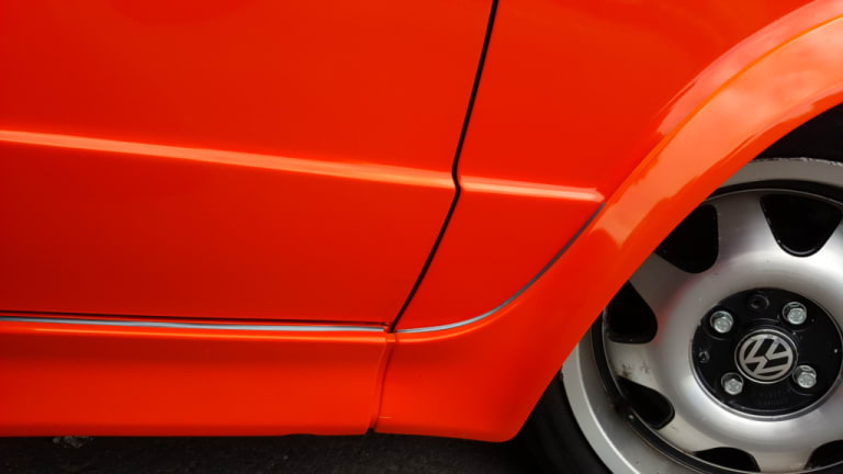

Do the corner bits of trim look the same as the trim running along the sides of the car?
It hard to see on your picture above as its's white on white but your side trim looks different to mine, my one looks like the one fitted to the red car?
Hi, the arch trims are different to the sides as in the shape on the edge that sticks onto the skirt is much narrorer to fit between the arch & body, the tape is useless so had to stick them myself, does look good when the kits all back onmark1gls said
