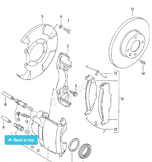

There is no difference between the Calipers on a Solid or Vented Golf/GTI. The Vented rotors required a thinner pad, which you see when you look up the etka that the pads are different for the vented vs solid rotors.abfmk1 said
No not gti, they have vented discs i believe, they are later mk1 non gti type i think..
You can use the Vented Rotor Pads on a Solid, but you will never get a Caliper to seat on a Solid Pad when you have vented rotors….
Over here on this side of the pond for quite a few years the parts stores all had the thicker pads listed for the Cabriolets, you had to get the 83 Rabbit GTI to select the vented rotors and the vented rotor pads.
Regional Host NE
https://volkswagen.7zap.com/en/rdw/golf+cabriolet/goc/1981-464/6/615-615013/
Briano1234 said
looks to be the earlier type of 239mm.

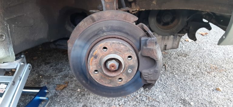

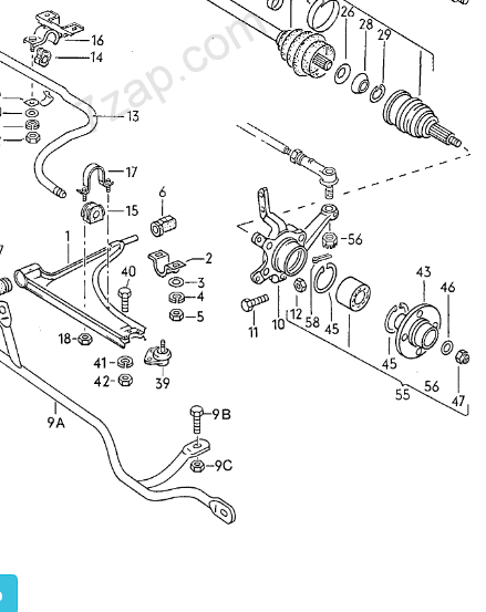

Yeah that looks right. Makes sense since mine is a 1980 gls. The thing I'm confused about is whether the carrier (2) can be removed from the hub. I've seen different people say that mk1 carriers are cast on to the hub or that they can be removed. I thought it was only early mk2's that had the carrier actually cast on as part of the hub.. Looking at the diagram and the images above it looks like they can. be removed. However I haven't seen just the carriers for sale new or used anywhere which made me wonder whether they were actually removable or not.
I'm fairly certain the calipers themselves are fine and that I just need new rubber sleeve for the slider pins so either this
https://www.ebay.co.uk/itm/VW-Golf-MK1-inc-GTi-Front-brake-caliper-guide-slider-pin-kit-bolt-Option-S7100/332185969408
Or this if I want to replace all the seals, pistons and bleed nipples
https://www.ebay.co.uk/itm/VW-Golf-MK1-1-5-1-6-1-8-Front-brake-caliper-repair-kits-pistons-48mm-PK252-2/333701479222
If however I wanted to upgrade the front brakes to 256 or 280mm, would I be able to do so without having to get different hubs if the carrier can be removed?
I am old school to me they are spindles.
