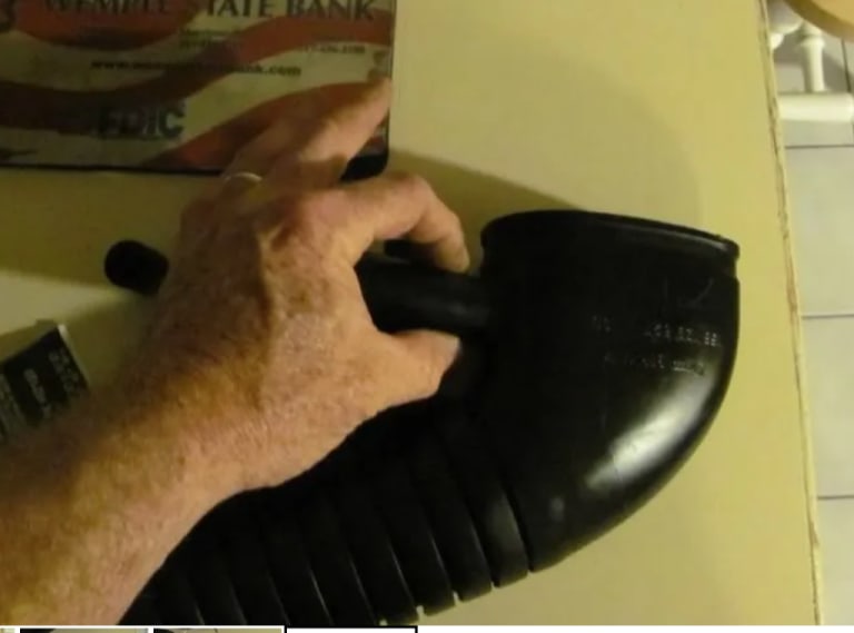

Another thing is Vacuum lines are a bane as there aren't that many but a vacuum leak can also be vexing,
The Air intake tube can hole or get soft where the isv connects to the hose.
https://www.vwvortex.com/threads/i-still-hate-plastic-parts-but-thanks-tolusina.6907318/?id=6907318&highlight=hate+plastic+parts
https://www.volkswagenownersclub.com/threads/digifant-air-intake-tube-repair.32188/
