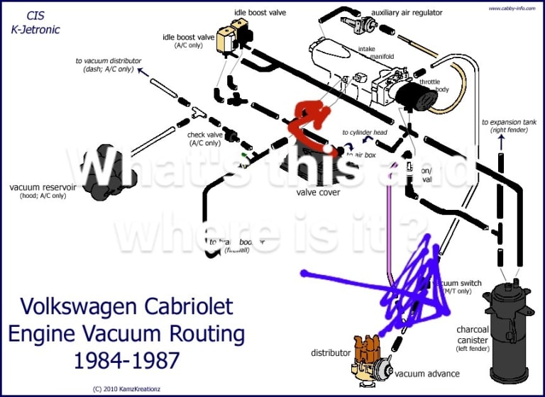

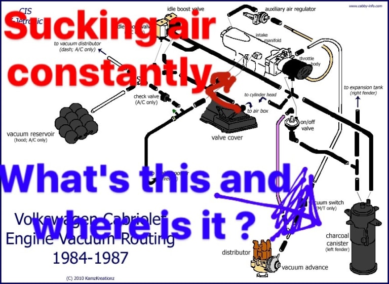

I want to get access to the charcoal canister on my mk1 golf gti dx 8v and I haven't a clue where it is!?

on the left of the wheel opening attached to the hard fender.
The pictures etc are America so slightly different from uk cars.
1993 my 1 golf clipper.

Oldman said
I have often wondered what various vacuum pipes disappear into the near side upper wheel arch for. Anything in there is well hidden and certainly not easy to gain access too.

WATERNAIR said
You'd know if you had one because they make a constant tapping / clicking noise.
Well they do when they work
It is located in the left side passenger fender, you have to remove the outer inner fender flare to get access to it. same thing you remove to get access to the antenna.
